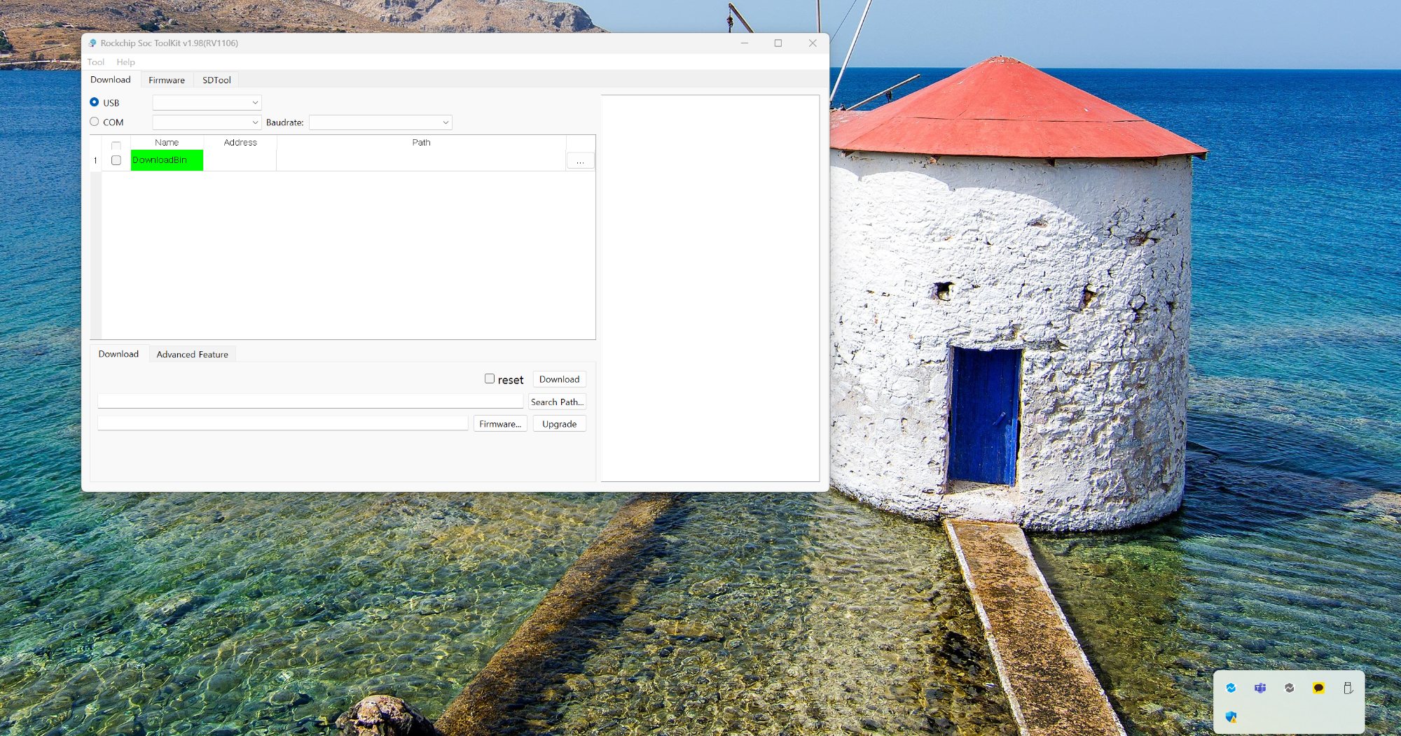

  • "I entered 'luckfox' as the password, but I get the result shown in the picture. Is there a way to reset the password or any other solution?"
  • The screenshot can be taken more comprehensively
