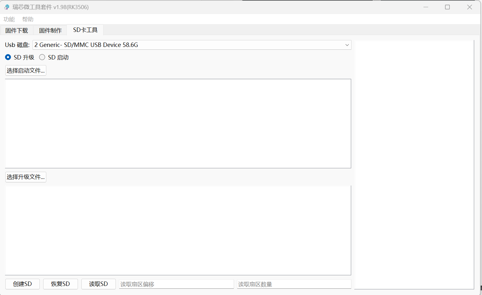

There is no limit to the size of the SD card. The following is an image of a 64GB SD card detected by the software.
https://files.luckfox.com/wiki/Luckfox- ... 01_win.zip
You can check if the software version is v1.98 and obtain it from the following linkThanks a lot. I had version 1.85 downloaded from Luckfox website: https://wiki.luckfox.com/Luckfox-Pico/L ... burn-image. I tried on another computer with the same result.
