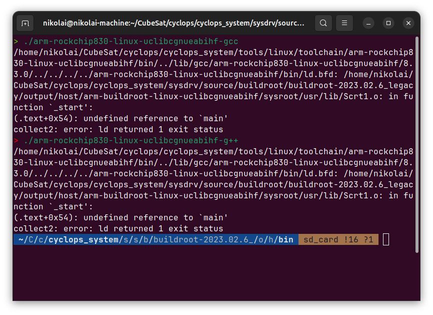

Calling these toolchain-wrapper symbolic links (arm-rockchip830-linux-uclibcgnueabihf-gcc and arm-rockchip830-linux-uclibcgnueabihf-g++), that are located at buildroot/output/host/bin/ directory, in terminal causes these errors:

final link failed: nonrepresentable section on outputCalling these toolchain-wrapper symbolic links (arm-rockchip830-linux-uclibcgnueabihf-gcc and arm-rockchip830-linux-uclibcgnueabihf-g++), that are located at buildroot/output/host/bin/ directory, in terminal causes these errors:
