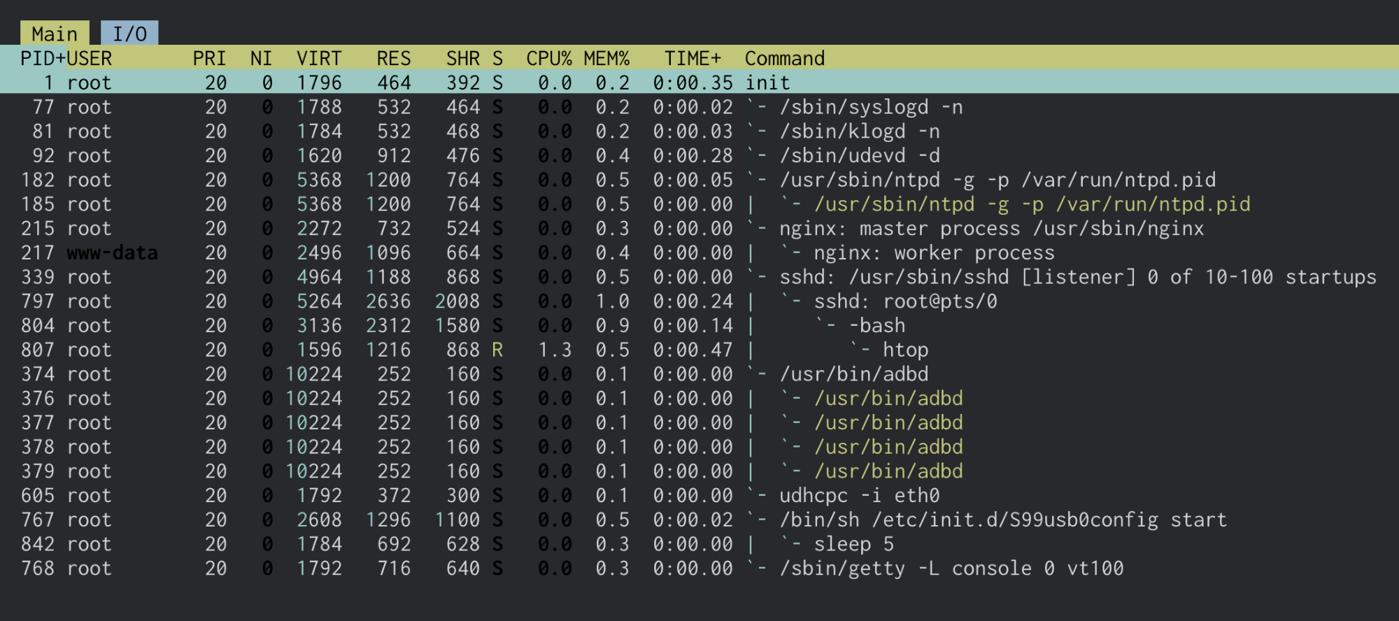

I'm trying get udhcpc to set the hostname (looking to run "udhcpc -i eth0 -x hostname:name").
I can't seem to figure out how udhcpc is invoked. Searched /etc/init.d but no script seems to invoke it. In the process tree the parent process is just init.
Does anyone know if this is something in the busybox or buildroot config to make it set the hostname?
