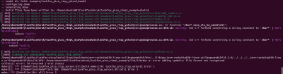

I am working on your RTSP demo. I am trying to decode the CSI input image after YOLOv5 detection. However, I am facing some issues. Initially, I tried to implement ZBar.
Here are the steps I followed:
git clone https://github.com/mchehab/zbar.git
cd zbar
autoreconf -vfi
./configure
make
sudo make install
Then, I added #include "barcode_read.h" to main.cc. I also modified the CMakeLists.txt file. I tried many different combinations, but in the end, I encountered the following error:

I have observed that your process does not seem to have configured a cross compilation environment for the zbar library. From the error message 'file format not recognized', I think this is a high possibility.

Yes, you are right. That's why I am trying to implement the ZBar Barcode Reader. However, I am facing some problems. I added the code to the main.cc, but I couldn't compile ZBar for arm-rockchip830-linux-uclibcgnueabihf. Can you help me?

Yes, you are right. That's why I am trying to implement the ZBar Barcode Reader(
https://github.com/mchehab/zbar). However, I am facing some problems. I added the code to the main.cc, but I couldn't compile ZBar for arm-rockchip830-linux-uclibcgnueabihf. Can you help me? Or can you suggest a different method to read the QR code?
