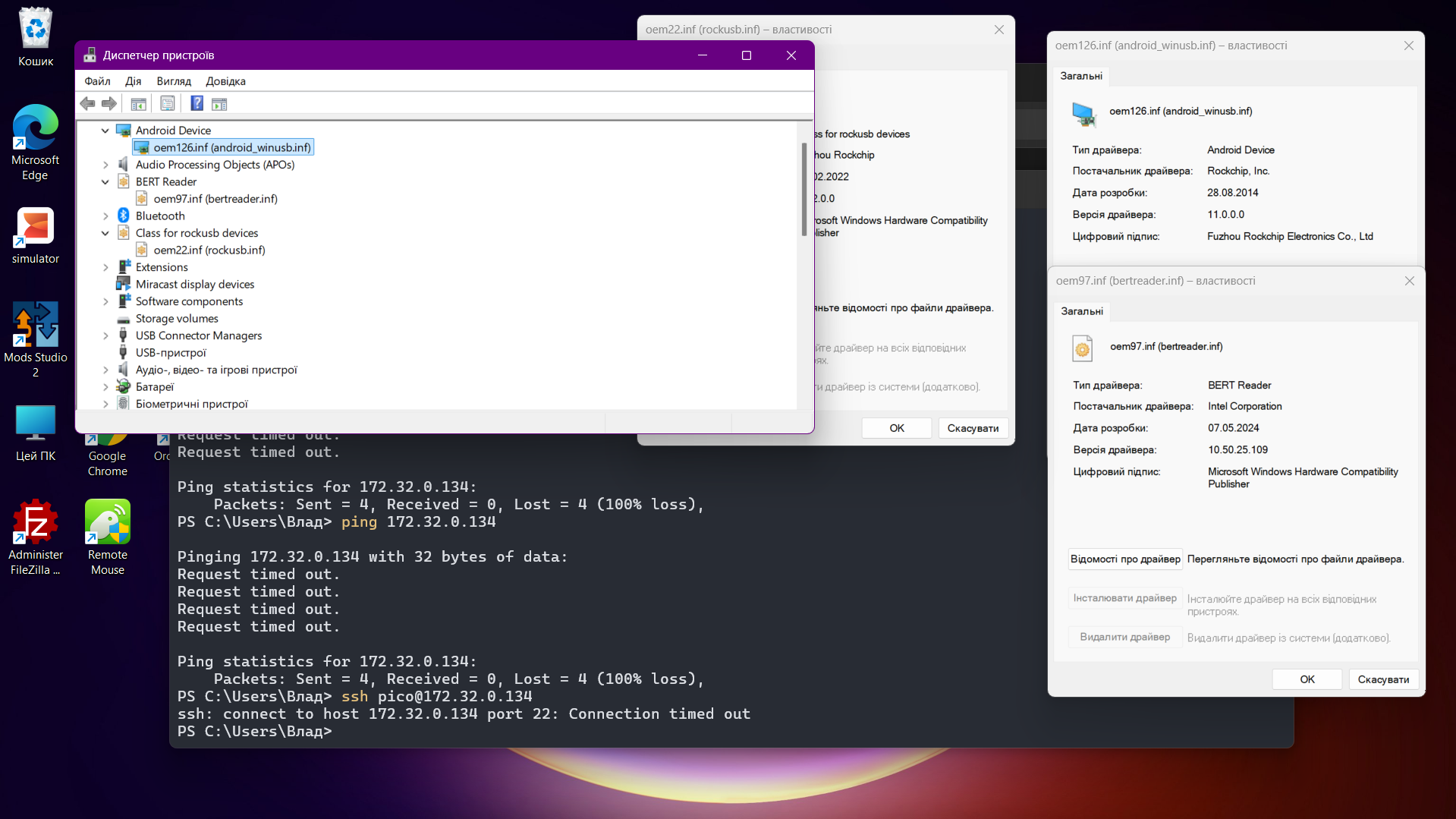

Im fix this error, but I can't connect to the moduleLuckfox Taylor wrote: ↑2025-02-27 1:51 When flashing with a card reader for the TF card, ENV errors usually do not occur. Please provide a screenshot so that our engineers can assist you in diagnosing the issue.
Hello, this appears to be a driver issue. By default, an ADB Interface should appear under Universal Serial Bus devices, and an RNDIS network adapter should be registered under Network Adapters. The oem126.inf device driver that appears in your Device Manager may have occupied the Luckfox Pico, preventing it from registering as an ADB device and an RNDIS network adapter.

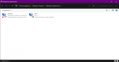

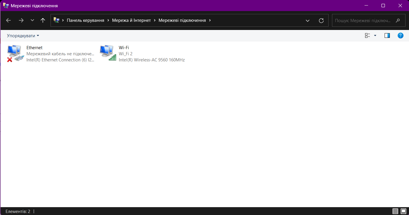

For some reason for my laptop (Lenovo thinkpad t490) RNDIS driver is not available.
