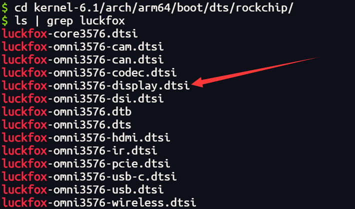

DP模式定义在 kernel-6.1/arch/arm64/boot/dts/rockchip/luckfox-omni3576-display.dtsi 中定义,可以根据自己的需求自行修改。

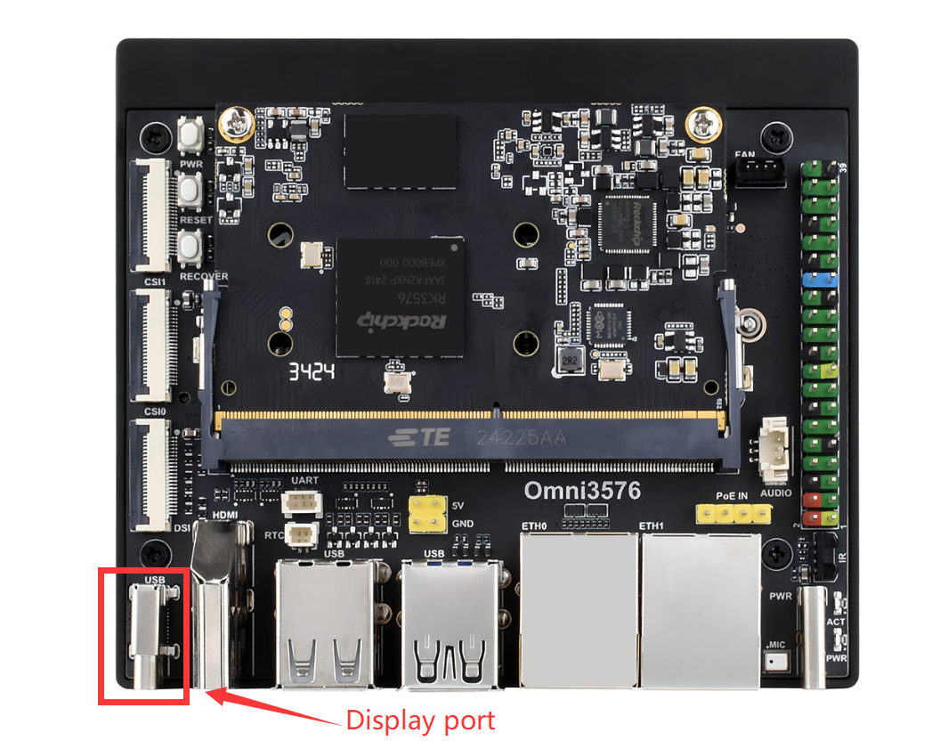

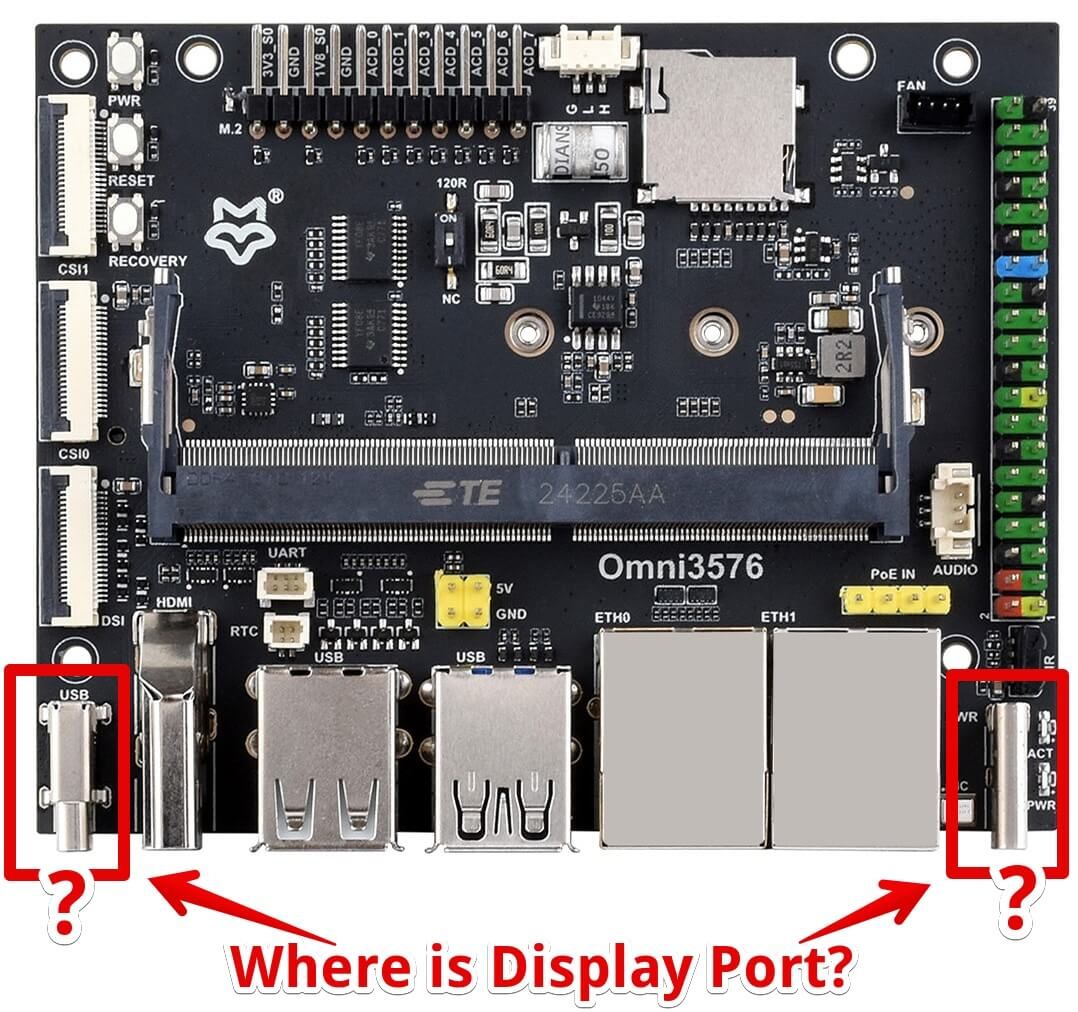

Can you please explain how to make DP (Display Port) working on USB Type-C port?
1. Which Omni3576 USB Type-C port is connected to the DP (Display Port) lines? Left or right?
There is no information about this in the wiki. Please add this information to the wiki.

Thank you for the image. Please add this image to the wiki for other users.
Could you answer the second question?

Thanks for pointing that out. I managed to build the image from sources following this manual: https://wiki.luckfox.com/luckfox-Omni35 ... ni3576-SDKLuckfox Taylor wrote: ↑2025-03-19 8:02 The display-related components are located in the following path
I successfully build the Debian image from SDK sources and flashed it to the board. I also found the dev tree file you pointed out:
Inside the luckfox-omni3576-display.dtsi file I found the section related to USB-DP:kernel-6.1/arch/arm64/boot/dts/rockchip/luckfox-omni3576-display.dtsi

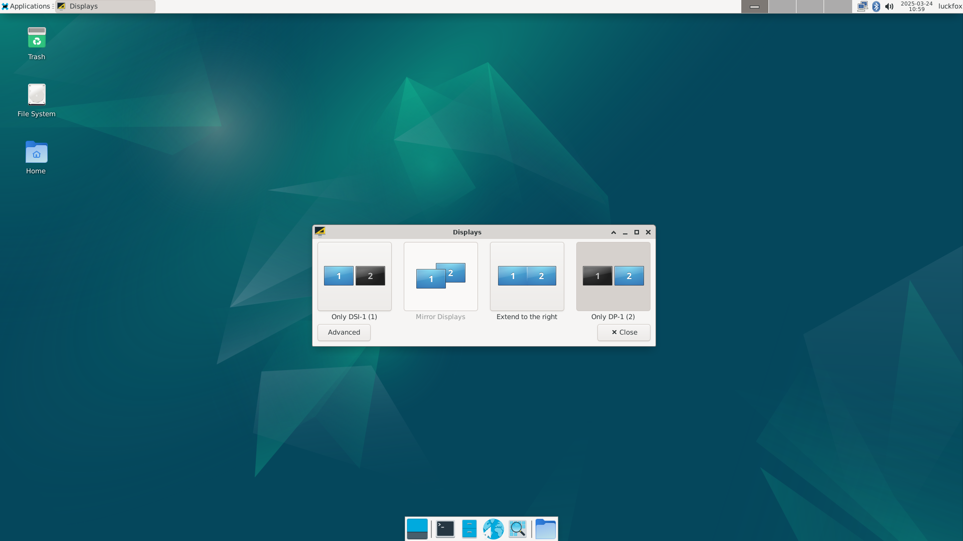

By default, this mirror supports DP, so you don’t need to turn it on in the device tree; this test can display normally.
