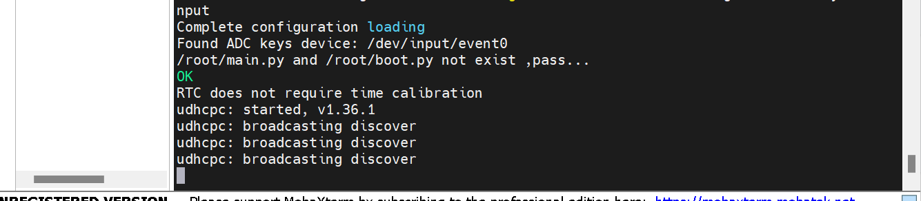

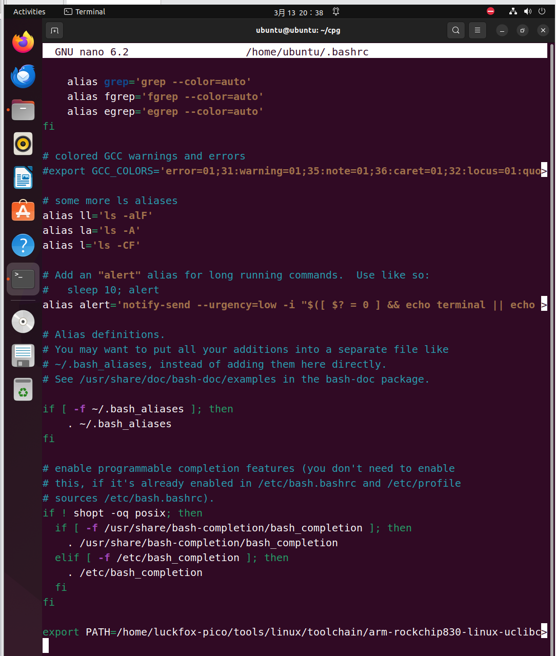

然后用串口登录上了,然后修改我的usb模式变成host,借上我的usb摄像头,检测设备检测不出结果,其余的什么都没做,
期间尝试了samba传输文件,也是链接失败(设置成host后)

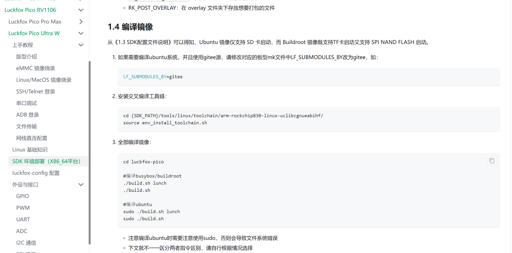

还有想问sdk是必须装的吗

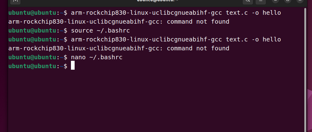

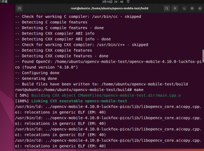

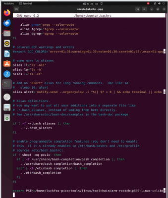

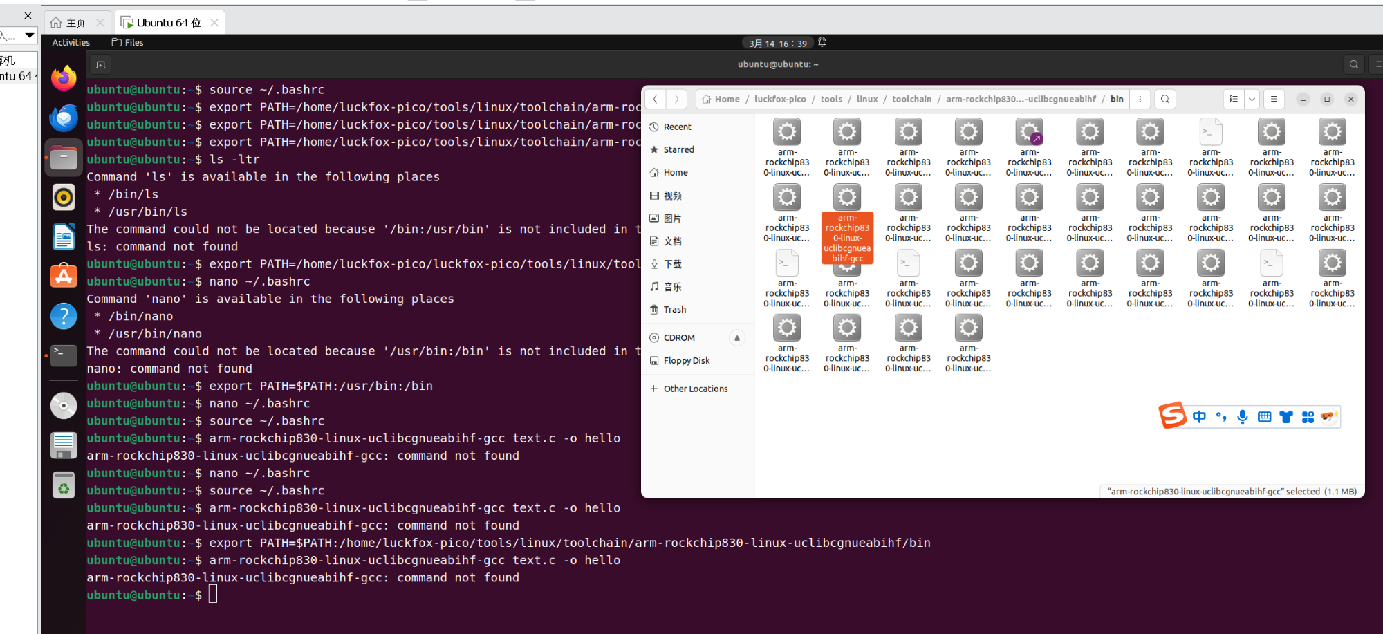

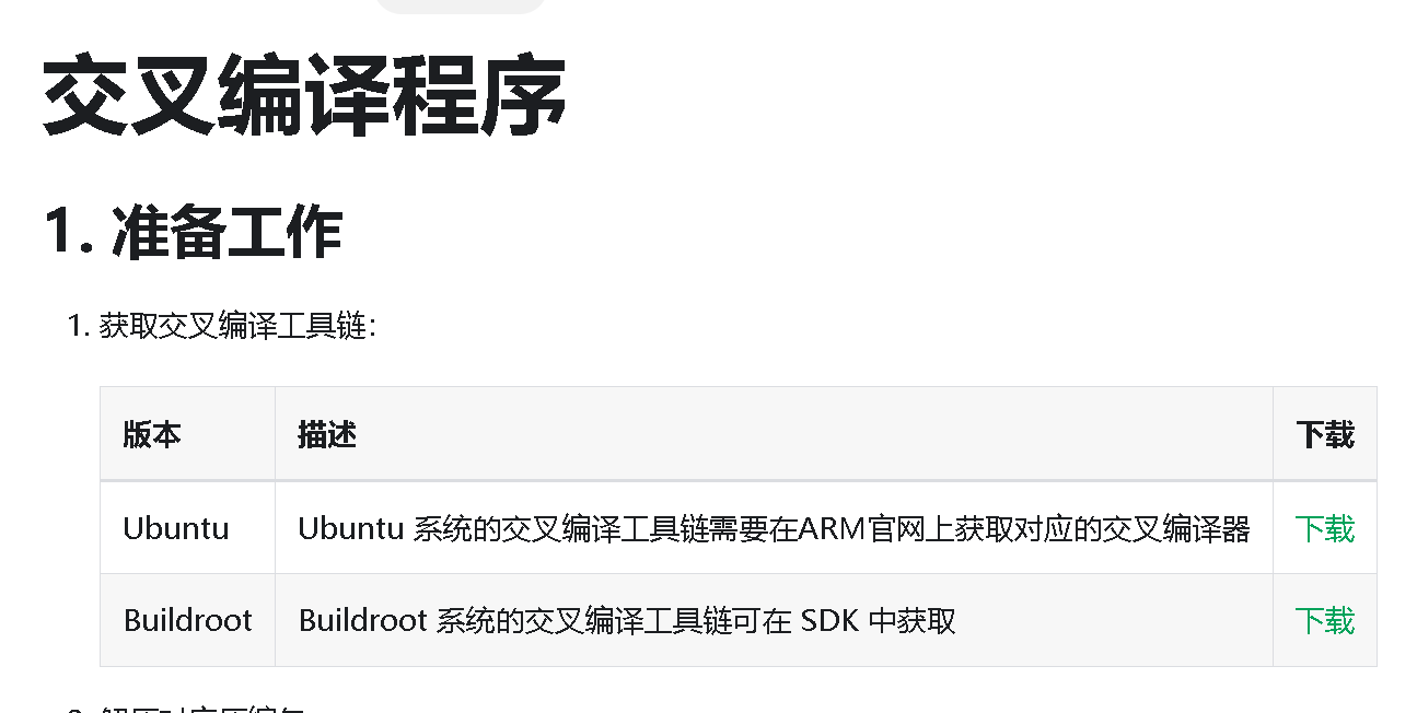

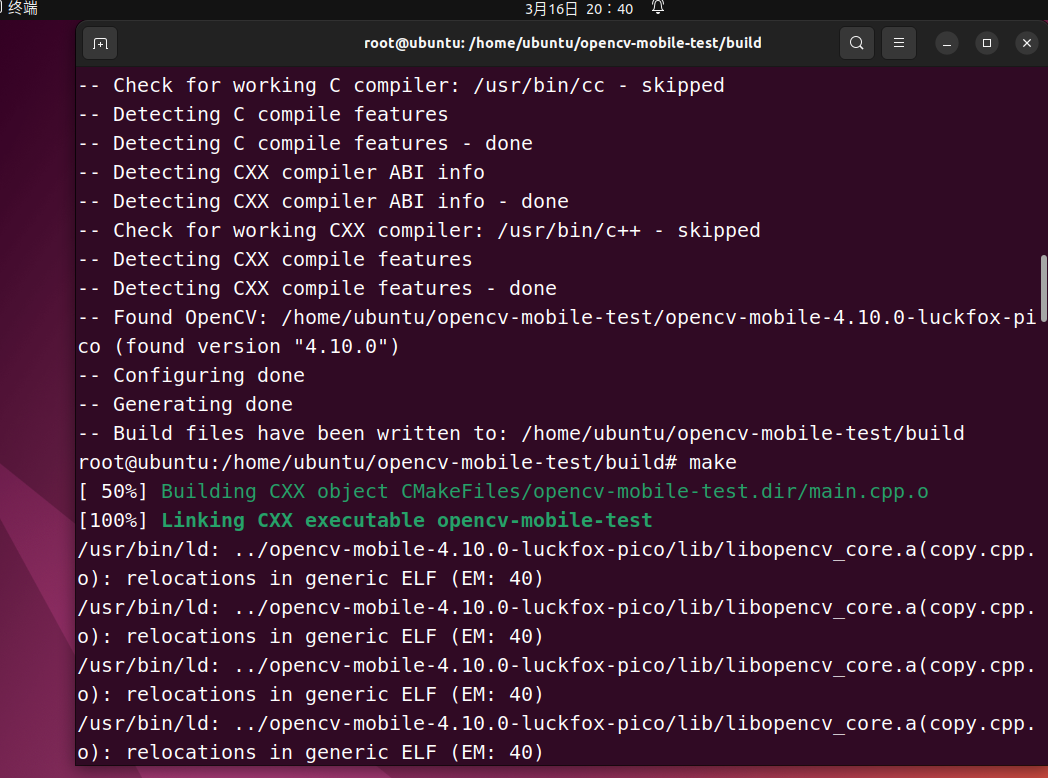

以及交叉编译程序我下载完后是直接在我的windows电脑上解压还是先送到开发板中再解压

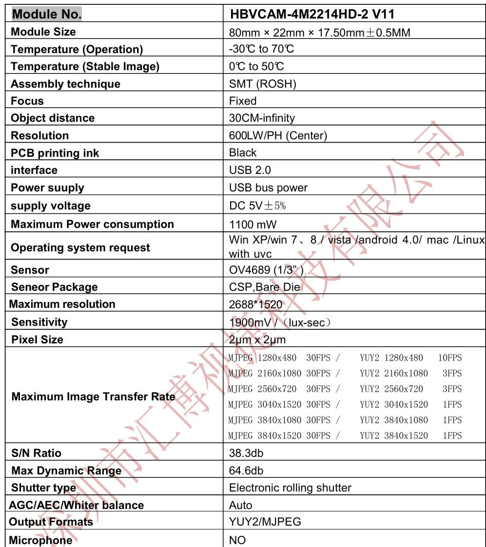

如果是按需的话,我的要求是用开发板的wifi模块无线传输我的usb摄像头的视频流(我的目前的方案是用python+opencv)或者说开发板本身就具有能实现这种功能的模块请指点我一下,谢谢

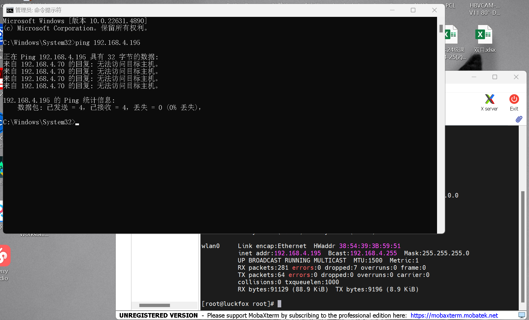

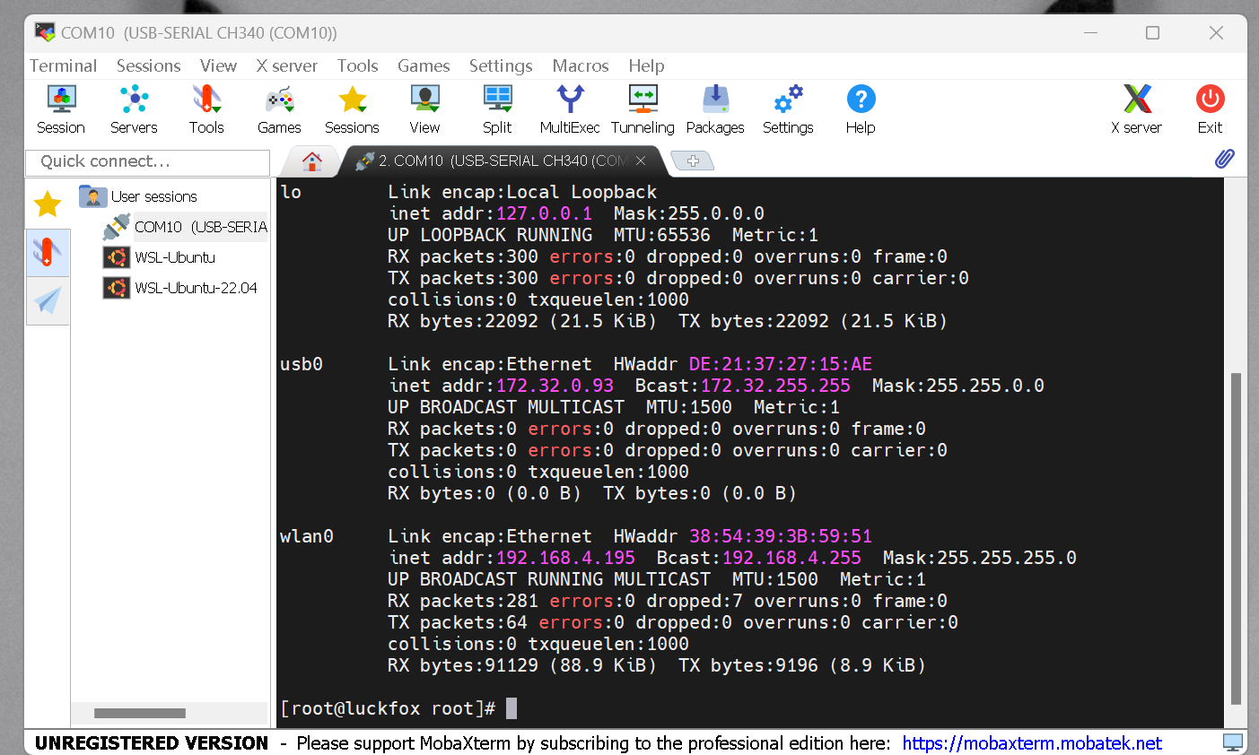

;附上我的摄像头参数以及ssh登录失败的截图

[root@luckfox root]# reboot
[root@luckfox root]# Stopping python: killall: python: no process killed
OK
Can't find /mnt/cfg/fdt_overlay dir!
FATAL ERROR: Couldn't open "/mnt/cfg/fdt_overlay/*.dts": No such file or directory
*.dts to dtbo error!
stop auto-reboot finished
Shutting down SMB services: OK
Shutting down NMB services: OK
[ 203.620688] dwc3 ffb00000.usb: request 37d5587b was not queued to ep0out
[ 203.620889] android_work: sent uevent USB_STATE=DISCONNECTED
[ 203.622139] read descriptors
[ 203.622170] read strings
Stopping telnetd: OK
Stopping sshd: OK
Stopping ntpd: OK
Stopping network: OK
Stopping bluetoothd: OK
Stopping system message bus: done
Stop Application ...
killall: rkipc: no process killed
Detected USB DISCONNECTED.
sh: write error: No such device
rkipc exit
ls: /oem/usr/etc/init.d/S??*: No such file or directory
Saving random seed... done.
stop[ 205.108848] printk: udevd: 17 output lines suppressed due to ratelimiting
killall: can't kill pid 2055: No such process
Stopping klogd: OK
Stopping syslogd: OK
Seeding 256 bits and crediting
Saving 256 bits of creditable seed for next boot
[ 205.187789] ffs_data_put(): freeing
[ 205.191526] EXT4-fs (mmcblk0p5): re-mounted. Opts: (null)
umount: /dev/block/by-name/oem busy - remounted read-only
umount: tmpfs busy - remounted read-only
umount: devtmpfs busy - remounted read-only
[ 205.221884] EXT4-fs (mmcblk0p7): re-mounted. Opts: (null)
The system is going down NOW!
Sent SIGTERM to all processes
Sent SIGKILL to all processes
Requesting system reboot
[ 207.229564] rockit get a system reboot event
[ 207.642044] mpp_vepu_pp ffa60000.rkvenc-pp: shutdown device
[ 207.651941] mpp_rkvenc_540c ffa50000.rkvenc: shutdown device
[ 207.657620] mpp_rkvenc_540c ffa50000.rkvenc: shutdown success
[ 207.663373] rkisp_hw ffa00000.rkisp: rkisp_hw_shutdown
[ 207.668586] reboot: Restarting system
