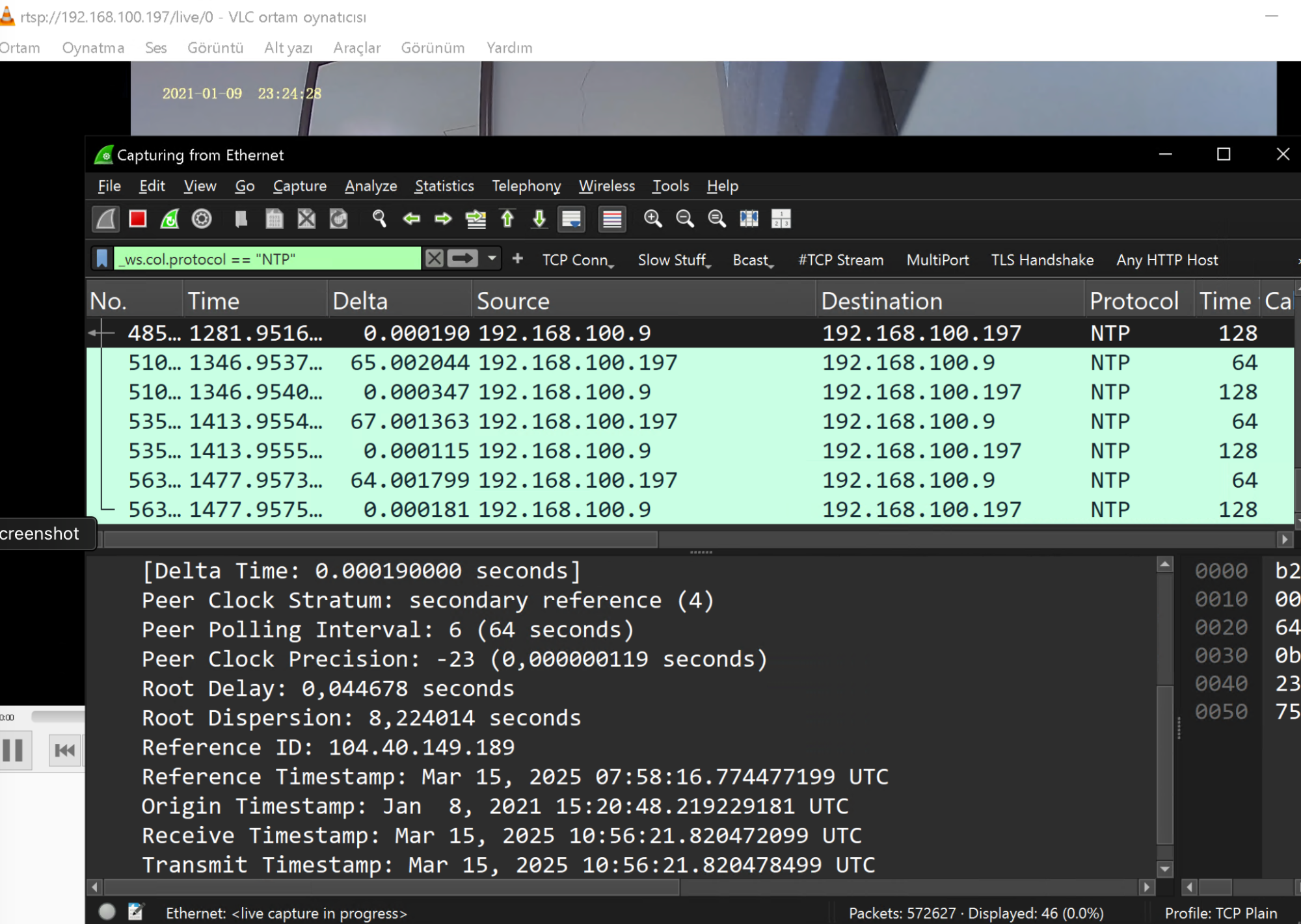

2) The overlay date&time on RTSP stream is not in sync with local NTP server.
2.a) I added local server ip in /etc/ntp.conf as "server 192.168.100.100 version 3" and reboot but date -R show a date from 2021. I also enabled ntp logs and perform UDP cap trace using wireshark. I can confirm server-client communication is in place. Note that nap services is provided by windows 10 machine in local network.

[root@luckfox root]# date -R
Sat, 09 Jan 2021 07:22:26 +0000
