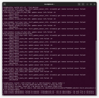

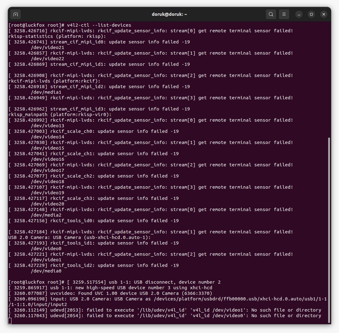

I entered the luckfox-config settings and switched to USB host mode. Then, I turned off the device, made the USB connection, and powered the device on. I followed the steps in this document:
https://wiki.luckfox.com/Luckfox-Pico/L ... x-Pico-USB. After running the command v4l2-ctl --list-devices, I get the following output. I couldn’t solve the issue, what should I do?
- Posts: 2084
The error is normal, rkcif is the driver related to the CSI camera, your /dev/video0 has been recognized as USB 2.0 Camera: USB Camera, and it should be normal to see the input format supported by the camera
