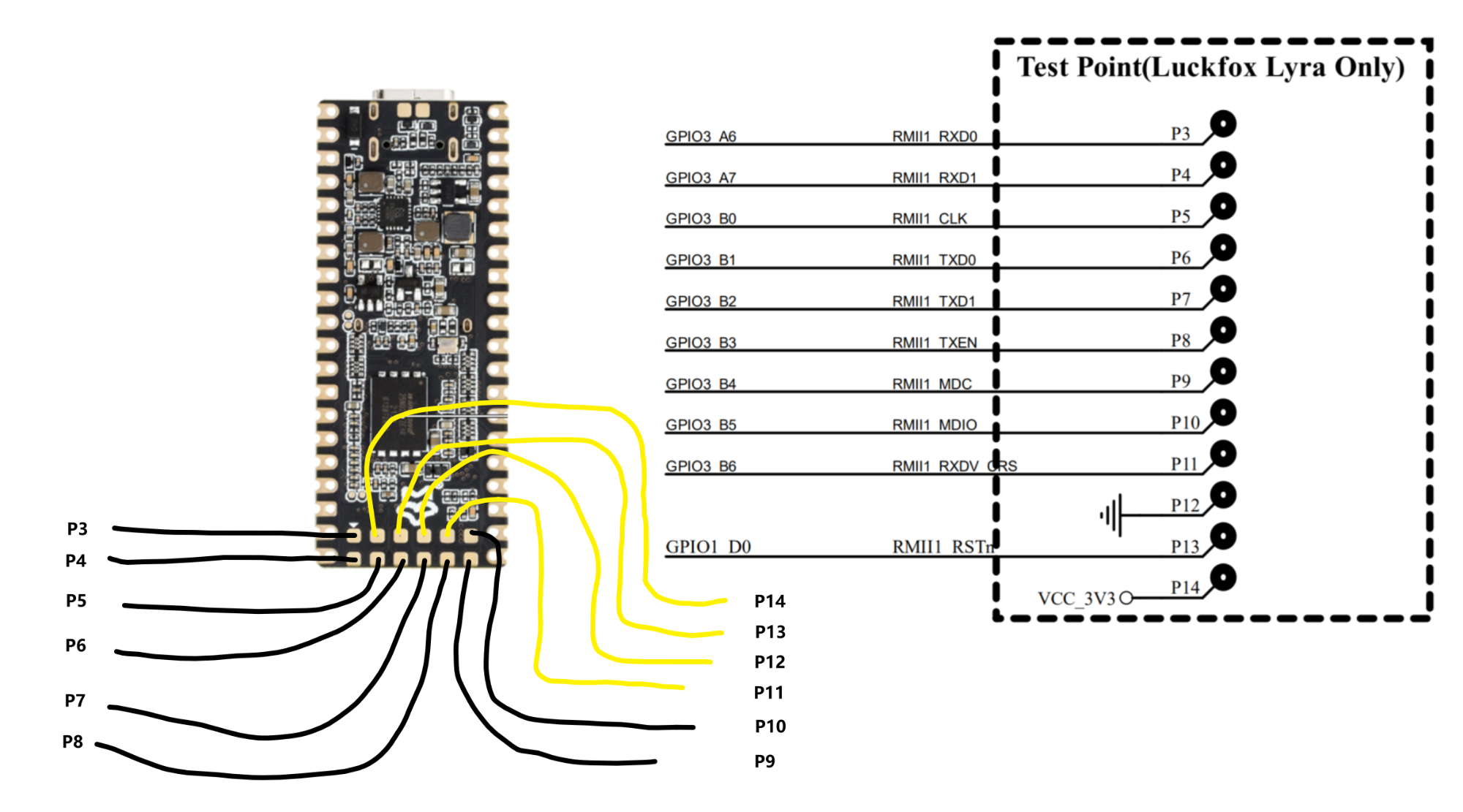

Hello, based on the schematic and images you provided, I have marked the test points. Could you please verify if these markings are correct?

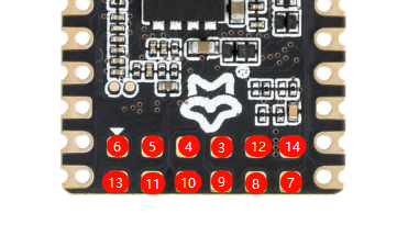

Hello, the location of the test point of Luckfox Lyra is shown in the picture

Thanks!
