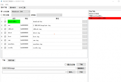

rv1106 fail to download firmware

Hello, please check whether there is any relevant driver installed, whether the storage media of the image used matches the storage media on the board, and provide the Luckfox Pico version and serial port output logs

thank you, it can download after update driver
