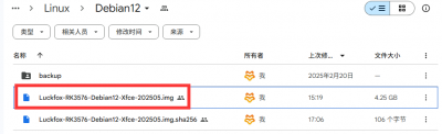

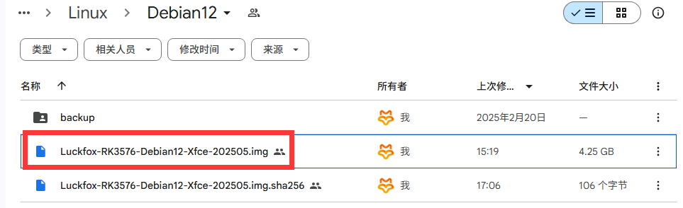

You can re - download the image from the network disk and burn it to the TF card. When the development board starts successfully, externally, the ACT light will flash. If the ACT light doesn't flash, it means the system failed to start. Try replacing the TF card and test again.
