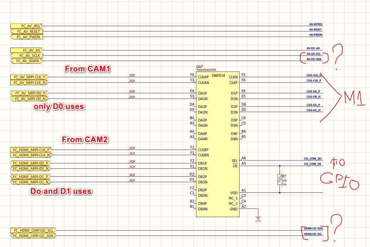

I am using two MIPI channels, M0 and M1, on RV1106G3.
An ordinary CSI-2 camera is connected to M0, and I have no questions regarding this channel.
For the M1 channel, I need to connect two cameras via a multiplexer:

Everything is illustrated in the attached screenshot.
Which I2C channels can be used jointly with both MIPI buses?
Hello, we do not provide technical support for hardware connections. This is because there are numerous factors to consider in hardware design. Any losses resulting from errors are beyond our responsibility. Additionally, based on your schematic, we cannot determine the model of the luckfox pico you are using.
The I2C and MIPI buses are different and have no connection. They are used in controlling the camera because I2C is required for some initialization and control flow operations.
