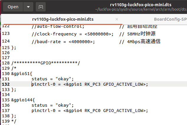

如果要设置GPIO为输入模式呢?
[root@luckfox ]# find -name 'gpio1*'
./sys/devices/platform/gpio1pc3
./sys/firmware/devicetree/base/aliases/gpio1
./sys/firmware/devicetree/base/gpio1pc3
./sys/firmware/devicetree/base/pinctrl/gpio/gpio1-pc3
./sys/firmware/devicetree/base/pinctrl/gpio1-pc7
./sys/firmware/devicetree/base/pinctrl/gpio1-pc7/gpio1-pc7
./sys/bus/platform/devices/gpio1pc3
./sys/bus/platform/drivers/reg-fixed-voltage/gpio1pc3
找到了上述文件,请问如果要改变电平应该对哪个文件进行操作呢?
