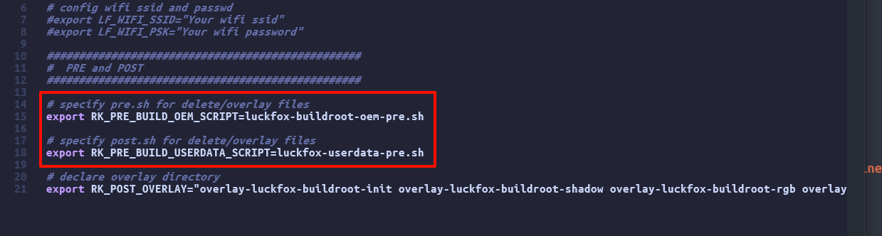

  • Hello, as shown in the attachment, remove these two lines of ".BoardConfig.mk" and then recompile to see if there is an "object_detection_pfp.data" file. If there is, burn it onto the board and connect the camera to modify "/oem/usr/ko/rkipc-300w.ini" by setting "enable_npu" to 1. Re-enable VLC streaming to see if there is a box when scanning for objects.
