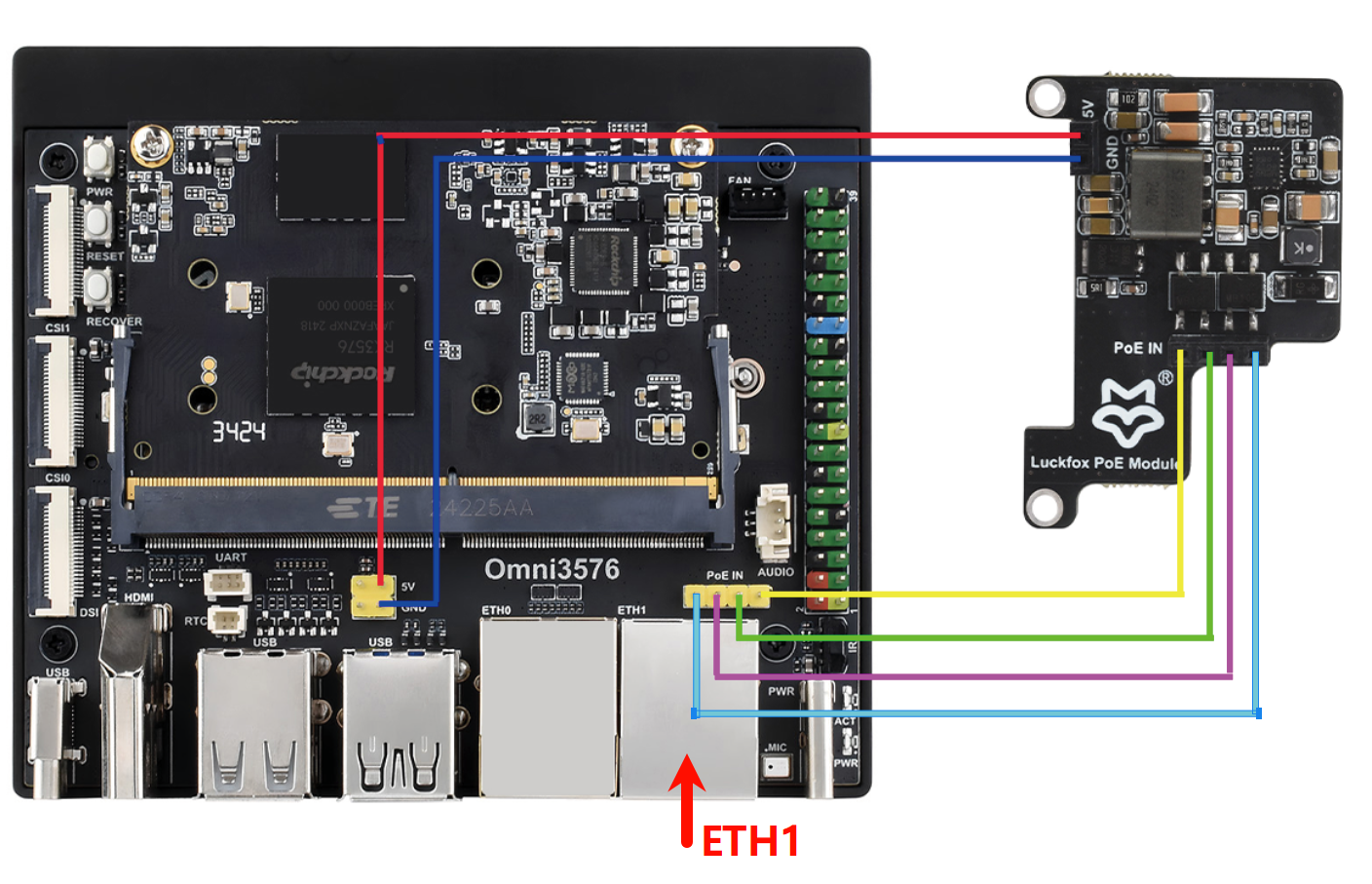

We do not have a dedicated POE module for this development board, but other POE modules can be used. If you have more requirements, please feel free to feedback to us.
If you have a Luckfox POE module, you can test it by wiring according to the instructions below. If you do not have a POE module, you can purchase this Raspberry Pi POE module and test it by wiring as follows.

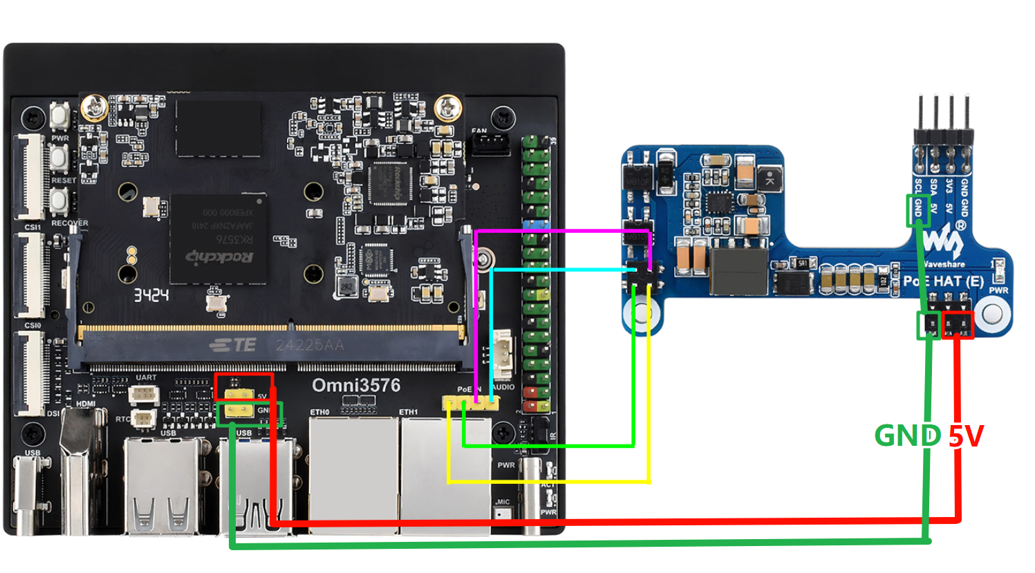

For the Raspberry Pi HAT, is there any need to disable the I2C fan control or other default HAT functionality since the board is only using the power pins, not the full 40-pin header?
