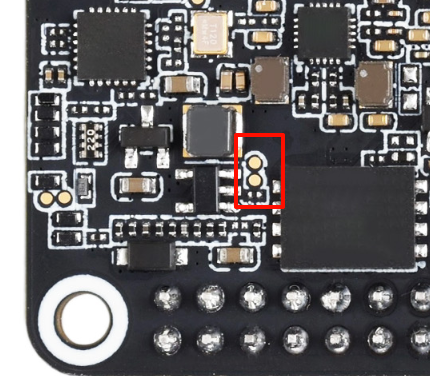

  • The Luckfox Lyra Zero W has two solutions to address this issue. One is to create a mirrored SD card for SD card booting, and then enter the download mode through the SD's Uboot to erase the SPI-NAND.
    The other is to short-circuit the two pads shown in the diagram and power on. After the computer recognizes the Maskrom mode, it can download the correct SPI-NAND image or erase the SPI-NAND.

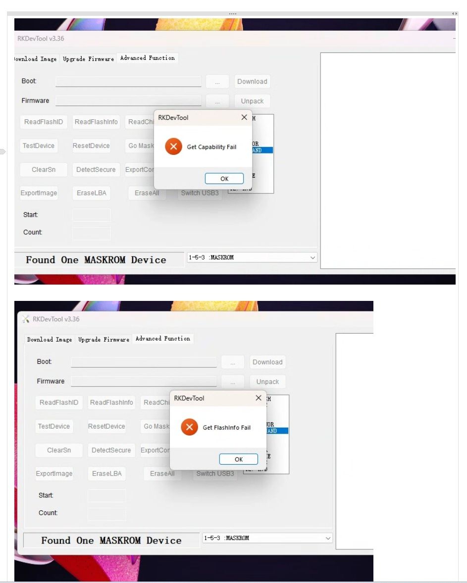

  • Hello, the device with VID:2207 PID:350F detected by lsusb is either Maskrom or the Luckfox Lyra in Fastboot mode. It is already normal and can be used for image burning. I noticed that you are using a system that seems to be MAC.
    I'm not sure about the compatibility of MAC system for image burning on Luckfox Lyra. If possible, it is recommended to try it on the Windows platform.
    The method of erasing the SPI-NAND image using the SD card image:
    1. Burn the update.img of Luckfox_Lyra_Zero_W_MicroSD onto the SD card.
    2. Boot the system using the SD card.
    3. Press and hold the boot button and then click the reset button to enter the download mode
    . 4. Open RKDevTool (only for Windows)->Advanced Function->Switch Storage->SPIAND->Erase All
  • do you have links to downloads for the MAC tool and the Windows Tool, where the TOOL actually runs in ENGLISH and not Chinese?
