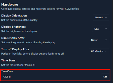

  • Hello,this is because you changed the time zone. The time zone of lvgl is based on the setting made by the front end.
  • so, what to do? login to gui, go to settings, time synchronization, there is option NTP, NTP ang HTTP??? I change to everything, restart, and always the same, wrong time on OLED? There is no option to change time in GUI of PICOKVM, except that.

  • The main interface displays the time which is synchronized via the network. Time zone configuration can be done on the web management page.
  • OMG, is that option always been there? I mean in app version 001?:) Or that is changed in new firmware version from Luckfox-PicoKVM-251014.img which bring app version to 003? Anyway, tnx a LOT! I didn't see that opt in GUI :)
