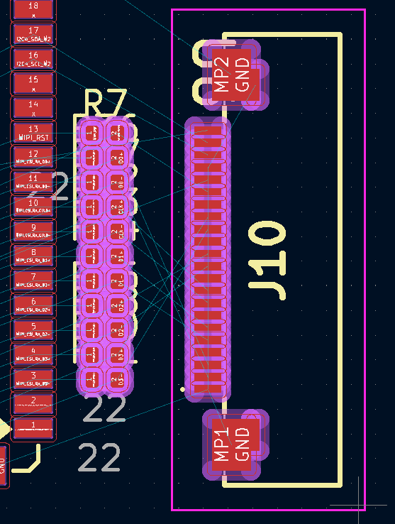

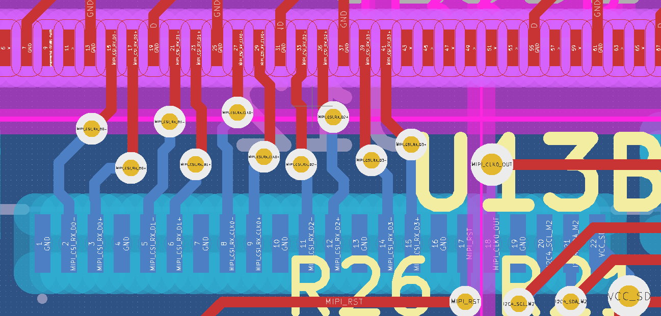

I want to use Core1106 with IMX415 8MP Camera Module (A) but the pinout on Core1106 is suboptimal for 4 lanes:
Pinout for Radxa CM5:
Ii seems Core1106 MIPI CSI-2 pinout is optimized for SC3336 3MP Camera (A) and the MIS5001 camera with 2 lanes. Is there some kind of work around for routing 4 lanes?
Difficult to route MIPI CSI-2 differential pairs on Core1106
Hello, PCB Layout requires consideration based on the actual situation. We do not provide any related technical support.
You can adjust the layout first and then proceed with the layout process to ensure there is sufficient space to maintain the equal length of differential lines, etc.
