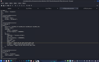

我现在正在在luckfox pico上驱动st7796s
系统是自定义的buildroot
我从https://github.com/Sergey1560/fb_st7796s获取了驱动并整合到我的源码树中
以下是dts:
fbtft@0 {
compatible = "sitronix,st7796s";
bgr;
reg = <0>;
spi-max-frequency = <100000000>;
fps = <60>;
buswidth = <8>;
debug = <0x7>;
led-gpios = <&gpio0 RK_PA4 GPIO_ACTIVE_HIGH>;//BL
dc-gpios = <&gpio1 RK_PD0 GPIO_ACTIVE_HIGH>;//DC
reset-gpios = <&gpio1 RK_PD1 GPIO_ACTIVE_LOW>;//RES
