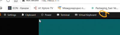

When I updated to the lates firmware and software of this amazing device, I lost the ability to use it with Fulscreen.
When you do you think this will be fixed as update , because I need that option... like this it is usless
Please advice
Lazar
Full Screen button not working
This issue has been fixed in version Sys0.1.6-App0.1.2. However, it has not yet been uploaded to the OTA server.

Hi, the fullscreen button still doesn't work. I have the latest updates
app version 0.1.1
system version 0.1.5
Edit : ok I need to wait for app version 0.1.2.

The fullscreen issue on the Luckfox PicoKVM isn’t a permanent bug—it has already been fixed, but only in a newer version (Sys 0.1.6 + App 0.1.2) that hasn’t been released via OTA yet. So if you’re still on App 0.1.1 / System 0.1.5, the button won’t work. In short, you just need to wait for the update (or manually install it if available), and fullscreen should work again.
Sys 0.1.6 and App 0.1.2 have been pushed to GitHub and the server. You can now perform an OTA update to obtain the latest version that fixes the full-screen function on the desktop.
