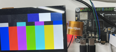

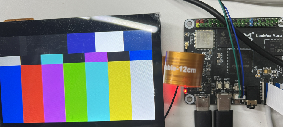

Please find attached the configured device tree and kernel image.

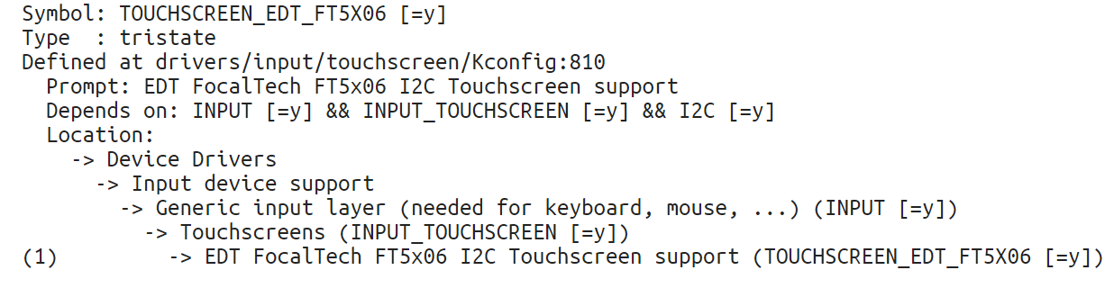

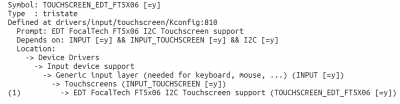

Touch functionality is not enabled in the default kernel. To enable touchscreen support, follow these steps:
1. Copy the driver source file:
2. Run the kernel configuration tool and enable the touchscreen driver:
3. Rebuild the kernel:
sudo cp edt-ft5x06.c sysdrv/source/kernel/drivers/input/touchscreenCode: Select all
sudo ./build.sh kernelconfigCode: Select all
sudo ./build.sh kernelThis issue with the LuckFox Aura and DSI display happens because full support is not yet officially ready.
Your screen showing white flashes and errors means the panel is not properly detected or configured. You need to use the provided custom device tree and kernel image from support, then rebuild the kernel and manually enable the touchscreen driver.
In short, it’s not your mistake, the feature is still incomplete, so using their patched files and rebuilding is currently the only working solution.
