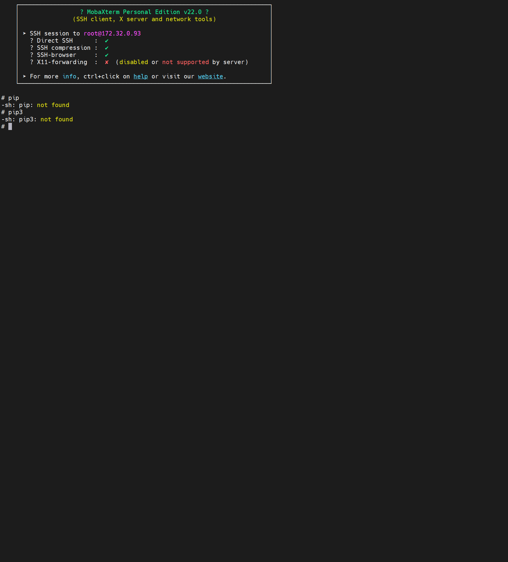

# pip
-sh: pip: not found
# pip3
-sh: pip3: not found
# python3

您好,实测是可以成功添加的,请查看wiki https://wiki.luckfox.com/zh/Luckfox-Pi ... x-Pico-SDK 检查是否遗漏了什么细节。
可以了, 谢谢, 之前烧了太多image, 弄混了...Crocodile wrote: ↑2024-06-04 2:17richard_yuan wrote: ↑2024-06-03 8:58选中了python-pip, 重新编译后,也发现没有pip. 请问是我哪里操作有问题吗Crocodile wrote: ↑2024-06-03 6:54
