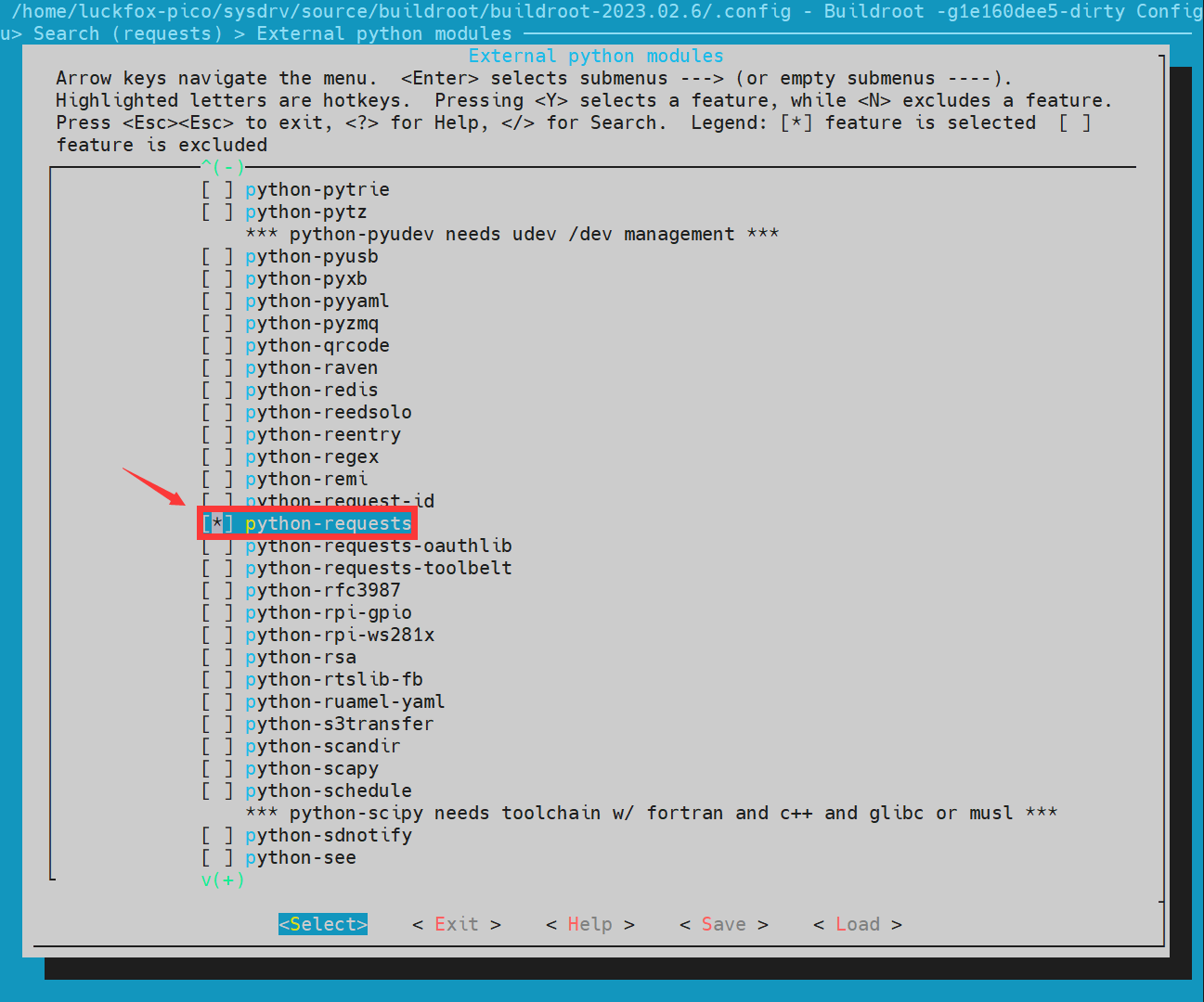

Adding Python libraries through Buildroot configuration is indeed feasible. For instance, to include the requests library, navigate to the Buildroot configuration interface and search for the 'requests' library. You will find an option named 'python-requests'. Enable this library and proceed with the subsequent steps according to the provided tutorial to successfully integrate it into your Buildroot environment.

To open the configuration interface, perform the following actions:
For a comprehensive tutorial and further details, please consult the official documentation:
https://wiki.luckfox.com/Luckfox-Pico/L ... Buildroot/
cd <SDK Directory>/sysdrv/source/buildroot/buildroot-2023.02.6/
make luckfox_pico_defconfig
make menuconfig

The <SDK Directory> refers to the file path where your SDK is located. For instance, if my SDK directory is "/home/luckfox-pico", you can open the Buildroot configuration interface by executing the following command:
cd /home/luckfox-pico/sysdrv/source/buildroot/buildroot-2023.02.6/
make menuconfig
