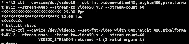

    Hello, please be aware not to shut down the rkipc background program while performing v4l2 image capture. This may result in the release of some initialized resources, causing abnormal operation.
    Kernel print information for normal operation of v4l2 image capture.
    Kernel print information for v4l2 image capture after shutting down rkipc.
