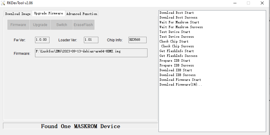

I've pressed erase in RKDevTool connecting my Core3566 in MASKROM mode. Since then it says Download Boot Fail whenever i try to upgrade with 2023-09-13-debian-arm64-HDMI-lite.img or Download MiniLoaderAll.bin. and also reset device fails. I'm able to boot sd card though.

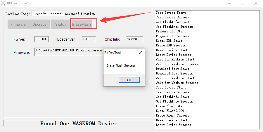

May I ask where did you click to erase? Could you please point out the screenshot of where you clicked to erase and the error message when downloading? From my end, clicking on the erase option still allows me to download normally.
I've clicked the same erase button that is pointed in your screenshot.

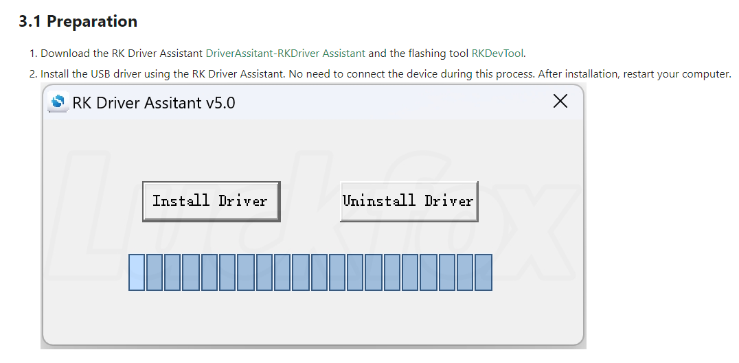

May I know what RKDriverAssistant or rockchip driver version did you use?Luckfox Taylor wrote: ↑2024-03-14 9:54 May I ask where did you click to erase? Could you please point out the screenshot of where you clicked to erase and the error message when downloading? From my end, clicking on the erase option still allows me to download normally.
