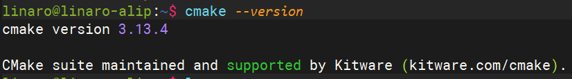

cmake --version3. 解压并赋予文件权限

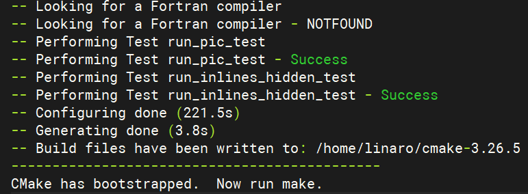

./configure
#运行结果
Cmake has bootstrapped. Now run make.Code: Select all

cmake --version
