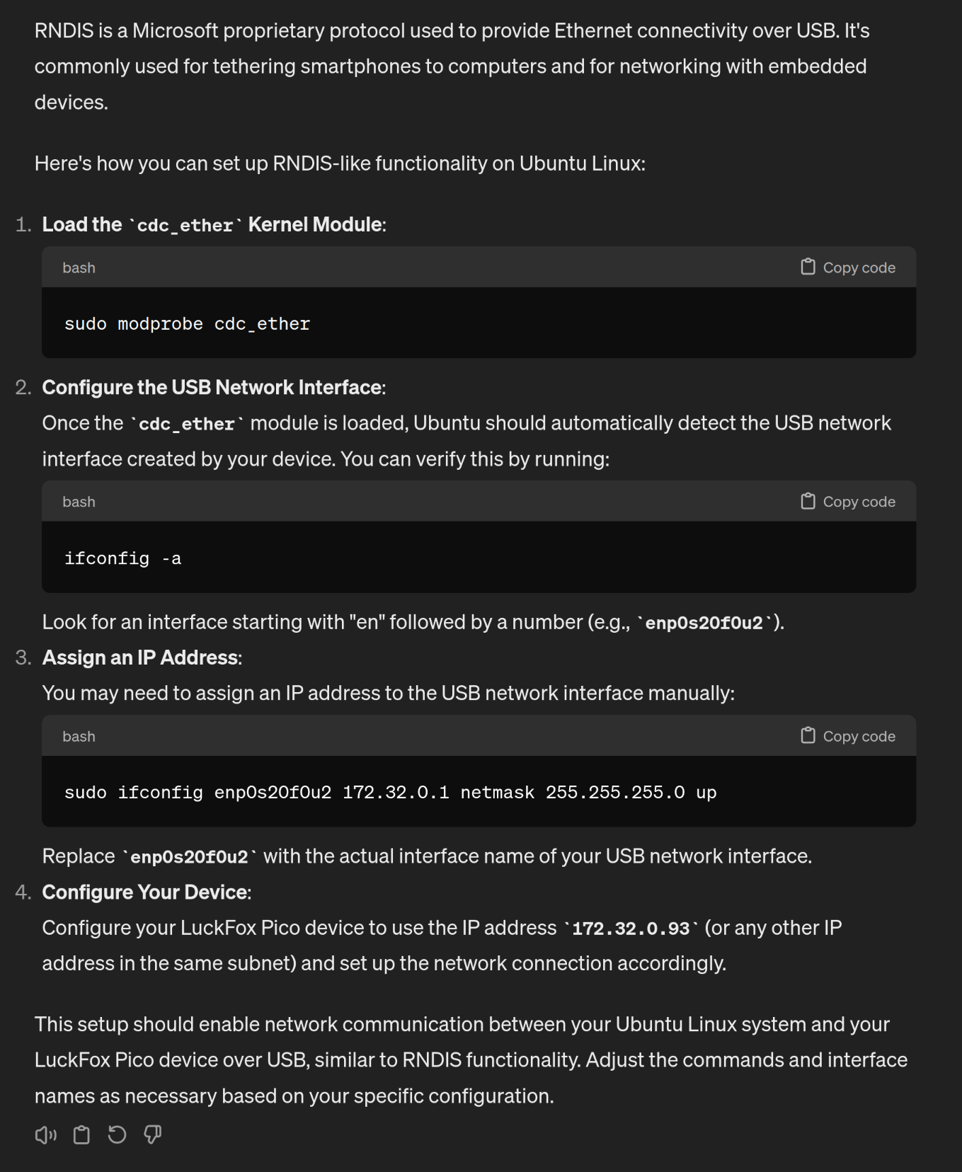

# The Luckfox Pico/Pico Mini A/B Login is ONLY for windows, but I found a solution for ubuntu:
https://wiki.luckfox.com/Luckfox-Pico/S ... i-ab-login
# mods the kernal, allowing usb internet I think
sudo modprobe cdc_ether
sudo apt update sudo apt install net-tools
ifconfig -a
# allowing us to use that network
sudo ifconfig exx00xx00x0x00x0x 172.32.0.1 netmask 255.255.255.0 up
ssh root@172.32.0.93

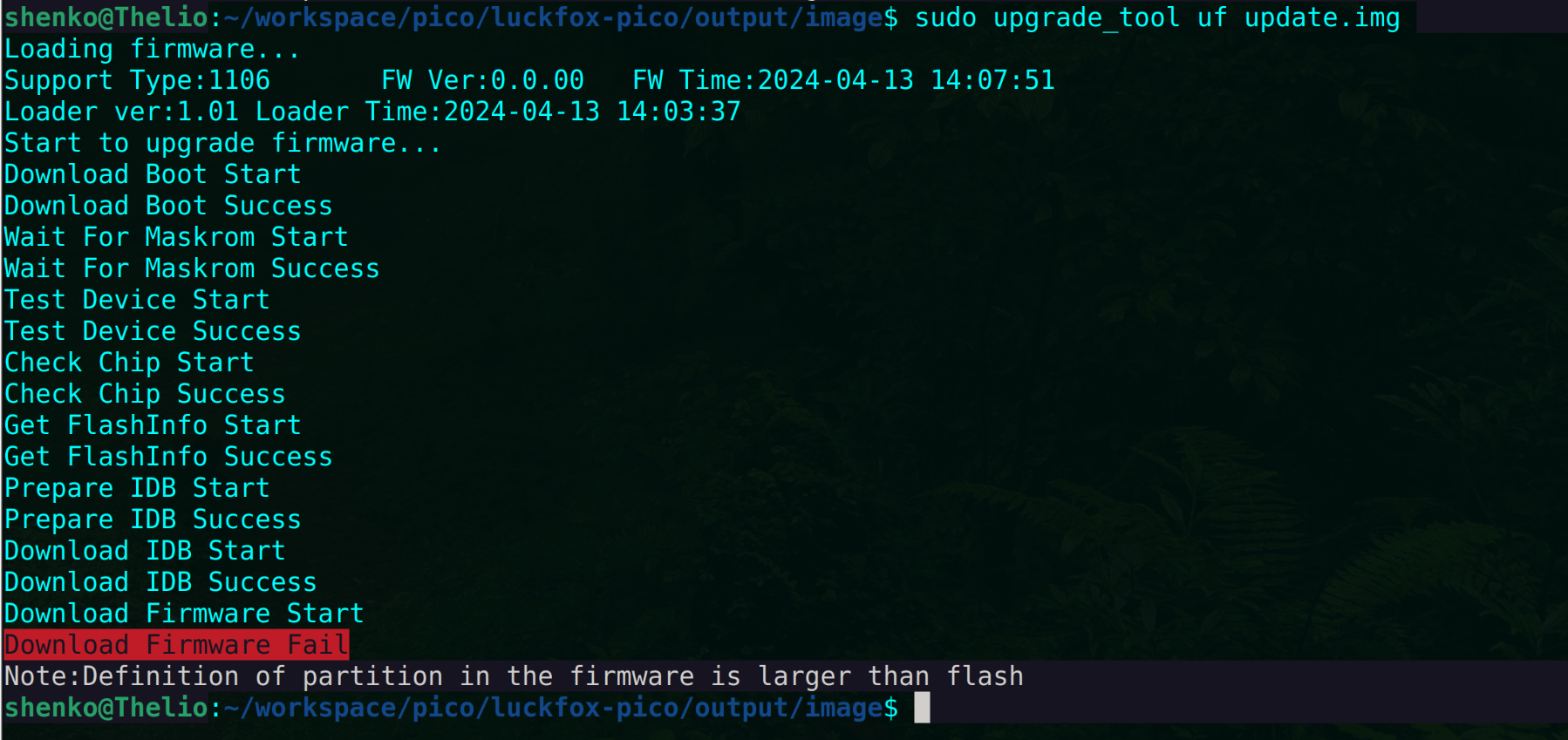

for the Luckfox mini Pico M, is there a ubuntu version?
Luckfox mini Pico M 没有“buildroot”,有 ubuntu 版本吗?

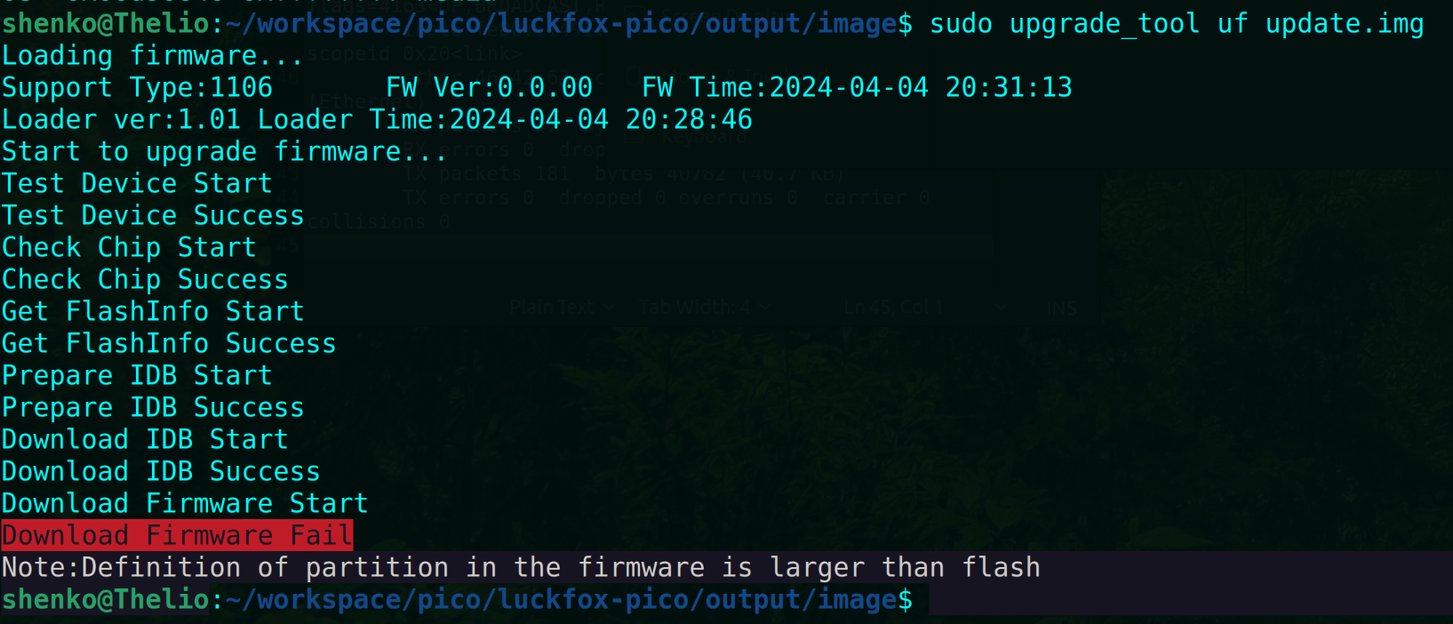

# When I build with option 2:
2. BoardConfig_IPC/BoardConfig-EMMC-Ubuntu-RV1103_Luckfox_Pico-IPC.mk
boot medium(启动介质): EMMC
system version(系统版本): Ubuntu
hardware version(硬件版本): RV1103_Luckfox_Pico
applicaton(应用场景): IPC
I get the following error:
我收到以下错误:
