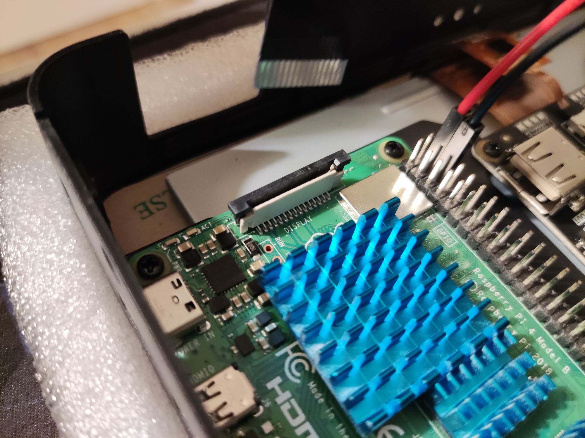

2. Please take a photo of how you have connected your Raspberry Pi to the display.

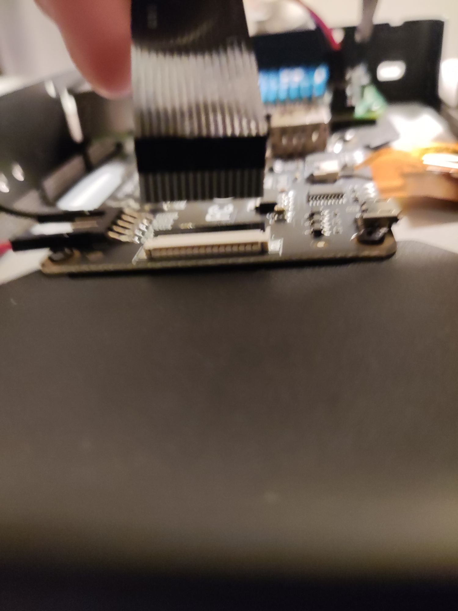

first of all sorry for my late reply, and thank you for your reply. i unfortunately cannot provide you with the kernel version of the system since i do not have a screen at the moment. i have one picture showing the connection on the RPI4B's side(disconnected to show the direction of the pins) and one for the screens side, also disconnected to show the pins direction. . here is what is written inside the config.text file:

1. Make sure the connection is normal. The connection method in the picture above is wrong, and the FPC does not seem to be provided by us ,Make sure the FPC is provided by us 2. If the above does not solve your problem, please try changing the system version of Raspberry Pi, such as Bullseye
