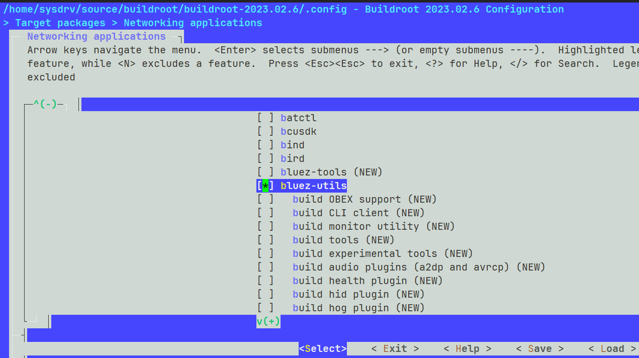

Found pkg-config: /home/sysdrv/source/buildroot/buildroot-2023.02.6/output/host/bin/pkgconf (1.6.3)
Found CMake: /usr/bin/cmake (3.22.1)
Run-time dependency libpcre found: NO (tried pkgconfig and cmake)
Looking for a fallback subproject for the dependency libpcre
output/build/libglib2-2.72.3/meson.build
A full log can be found at /home/sysdrv/source/buildroot/buildroot-2023.02.6/output/build/libglib2-2.72.3/build/meson-logs/meson-log.txt
make[1]: *** [package/pkg-generic.mk:283: /home/sysdrv/source/buildroot/buildroot-2023.02.6/output/build/libglib2-2.72.3/.stamp_configured] Error 1
make[1]: Leaving directory '/home/sysdrv/source/buildroot/buildroot-2023.02.6'
make: *** [Makefile:524: buildroot] Error 2
make: Leaving directory '/home/sysdrv'
[build.sh:error] Running build_rootfs failed!
[build.sh:error] exit code 2 from line 551:
[build.sh:info] make rootfs -C ${SDK_SYSDRV_DIR}
上面报错信息中提到具体日志查看/home/sysdrv/source/buildroot/buildroot-2023.02.6/output/build/libglib2-2.72.3/build/meson-logs/meson-log.txt文件,该文件中最末尾报错信息如下:
