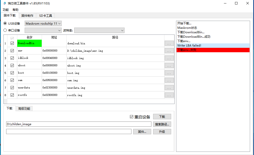

Luckfox Pico Plus 更换新的Flash后,如何更改FLASH ID,从而烧录固件
SPI NAND FLASH Image burning
The cable and the computer USB port are good

Can you access the system via SD card? You can test with the system provided in the cloud drive.wenjie wrote: ↑2024-06-07 8:39Code: Select all
RKUARTDDR V1.10 ec2fae0c96 wesley.yao 22/11/15-10:58:09 S5P1 fc27 rgef0 rgef1 DDRConf1 DDR2, BW=16 Col=10 Bk=4 CS0 Row=13 CS=1 Die BW=16 Size=64MB 528MHz DDR bin out Boot1 Release Time: Aug 12 2022 17:14:00, version: 1.06 NO FTL rom_version: 0x30303256 Boot from dev = 129 hamming_distance:1103 1106 2 chip_id:5256110300,0 ChipType = 27 0xff3e0040: 0x49 sfc nor id: ff ff ff sfc_nand id: ff ff ff Set sdmmc2 Clk: 200, 1 Set sdmmc2 Clk: 200, 1 SDC_BusRequest: CMD=1 SDC_RESP_TIMEOUT 1736 mmc2:cmd1,20 emmc reinit Set sdmmc2 Clk: 200, 1 SDC_BusRequest: CMD=1 SDC_RESP_TIMEOUT 1736 mmc2:cmd1,20 emmc reinit Set sdmmc2 Clk: 200, 1 SDC_BusRequest: CMD=1 SDC_RESP_TIMEOUT 1736 mmc2:cmd1,20 SdmmcInit=2 1 UsbBoot ...33728 0xff3e0040: 0x49 powerOn 38997
In previous tests to verify the normal operation of the product, I encountered a situation similar to yours, and ultimately found that the main control chip was short-circuited. So, please observe whether the chip heats up significantly when powered on, or use a regulated DC power supply to test if the chip is receiving power properly.
Luckfork Pikoppleluth was unable to find the Staka version of the firmware.Crocodile wrote: ↑2024-06-07 9:02Can you access the system via SD card? You can test with the system provided in the cloud drive.wenjie wrote: ↑2024-06-07 8:39Code: Select all
Luckfork Pikoppleluth was unable to find the SD card version of the firmware.Crocodile wrote: ↑2024-06-07 9:02Can you access the system via SD card? You can test with the system provided in the cloud drive.wenjie wrote: ↑2024-06-07 8:39Code: Select all
There is no obvious heating when the chip is powered on, and the chip is powered on normally.
