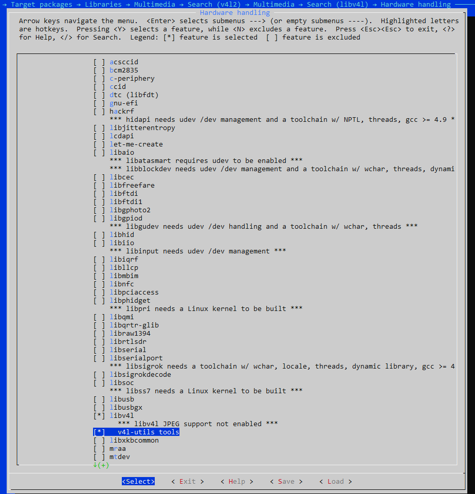

Following the instructions in the links below, I configured the buildroot to use the v4l2 module via WSL2.
https://wiki.luckfox.com/Luckfox-Pico/CSI-Camera/
https://wiki.luckfox.com/Luckfox-Pico/L ... figuration
viewtopic.php?p=1883&hilit=libv4l2&sid= ... 54ad#p1883

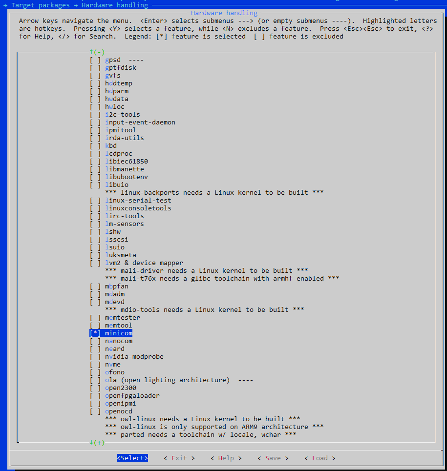

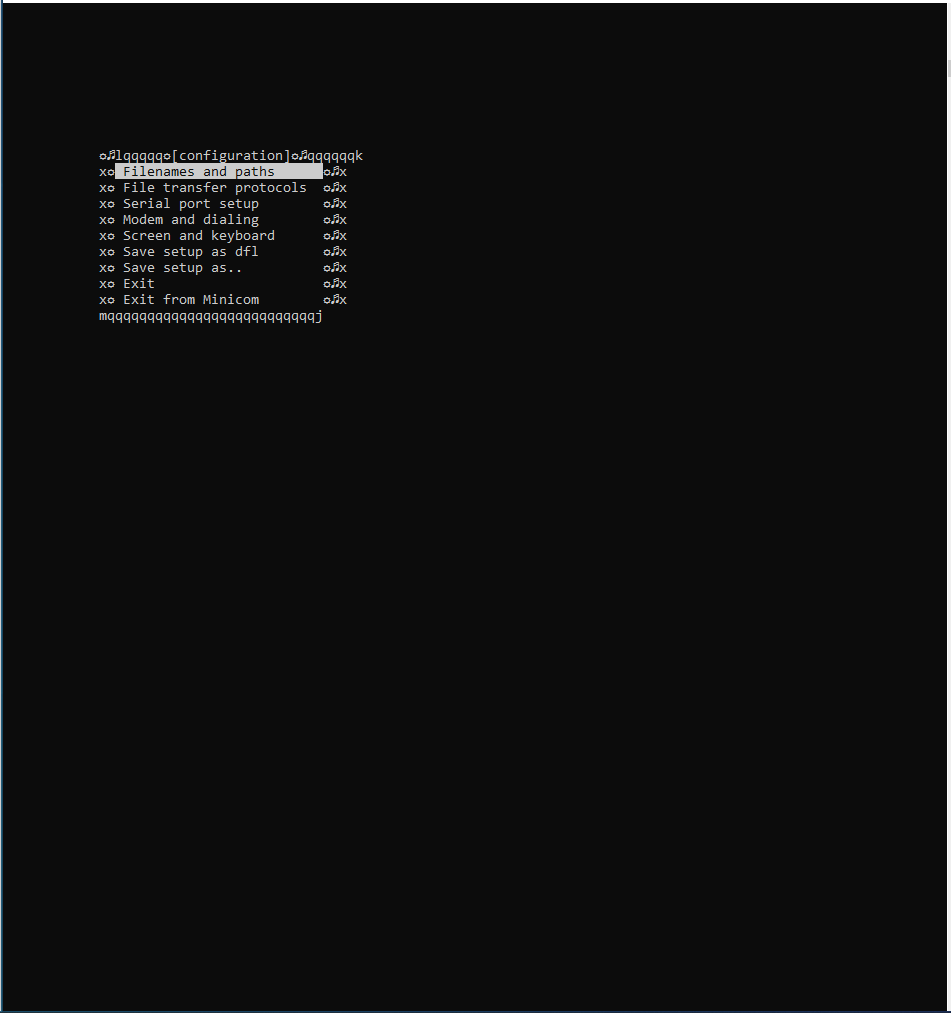

But this module remains unconnected. As an experiment, I connected minicom and iftop modules, which were initially unavailable on the device, and after rebuilding the buildroot they became active.
However, no matter what I do, v4l2 remains unavailable.
for edit buildroot:
cd sysdrv/source/buildroot/buildroot-2023.02.6/
make luckfox_pico_defconfig
make menuconfig
make savedefconfig
make
./build.sh lunch
./build.sh
