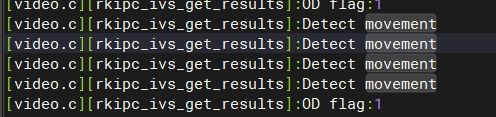

    I'm trying to record video or images if motion is detected. It appears that the demo software detects motion and prints out some info to the terminal. How can I modify the software so that video or image files are stored on the SD card for example when motion is detected?
    I'm also aware of the standard linux motion software which I included in my built image but I'm having trouble setting up the video source. I'm getting "V4L2 device failed to open"
    Thanks!

  • Crocodile wrote: 2025-04-26 2:43 Hello, your needs need to modify the source code, get the frame data of the VI when triggering Motion Detect and save it, the default rkipc application supports the jpeg capture function, the attachment is the development instructions of the rkipc application, you can save the jpeg by calling the rk_take_photo function
    The solution was surprisingly easy! I simply switched on cycle snapshot when motion was detected and switched it off if there was no motion. This is the modified function in video.c:
    static void *rkipc_ivs_get_results(void *arg) {
    	LOG_DEBUG("#Start %s thread, arg:%p\n", __func__, arg);
    	prctl(PR_SET_NAME, "RkipcGetIVS", 0, 0, 0);
    	int ret, i;
    	IVS_RESULT_INFO_S stResults;
    	int resultscount = 0;
    	int count = 0;
    	int md = rk_param_get_int("ivs:md", 0);
    	int od = rk_param_get_int("ivs:od", 0);
    	int width = rk_param_get_int("video.2:width", 960);
    	int height = rk_param_get_int("video.2:height", 540);
    	int md_area_threshold = width * height * 0.3;
    	while (g_video_run_) {
    		ret = RK_MPI_IVS_GetResults(0, &stResults, 1000);
    		if (ret >= 0) {
    			resultscount++;
    			if (md == 1) {
    				if (stResults.pstResults->stMdInfo.u32Square > md_area_threshold) {
    					LOG_INFO("MD: md_area is %d, md_area_threshold is %d\n",
    					         stResults.pstResults->stMdInfo.u32Square, md_area_threshold);
    					if (cycle_snapshot_flag == 0){
    						rk_video_set_enable_cycle_snapshot(1);
    						LOG_INFO("Cycle snapshot enabled!\n");
    				else if (cycle_snapshot_flag == 1){
    					rk_video_set_enable_cycle_snapshot(0);
    					LOG_INFO("Cycle snapshot disabled!\n");
    			if (od == 1) {
    				if (stResults.s32ResultNum > 0) {
    					if (stResults.pstResults->stOdInfo.u32Flag)
    						LOG_INFO("OD flag:%d\n", stResults.pstResults->stOdInfo.u32Flag);
    			RK_MPI_IVS_ReleaseResults(0, &stResults);
    		} else {
    			LOG_ERROR("get chn %d fail %d\n", 0, ret);
    			usleep(50000llu);
    	return NULL;
