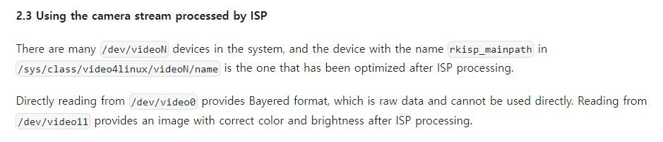

https://wiki.luckfox.com/Luckfox-Pico/L ... ncv-mobile However, I tried to capture video from /dev/video0 by referring to the following blog, but it did not work well.
Capture a picture with V4L2 : https://www.marcusfolkesson.se/blog/cap ... with-v4l2/
As explained in the blog, the information of /dev/video0 is as follows.

I'm also curious if it's possible to capture video directly from /dev/video0.
