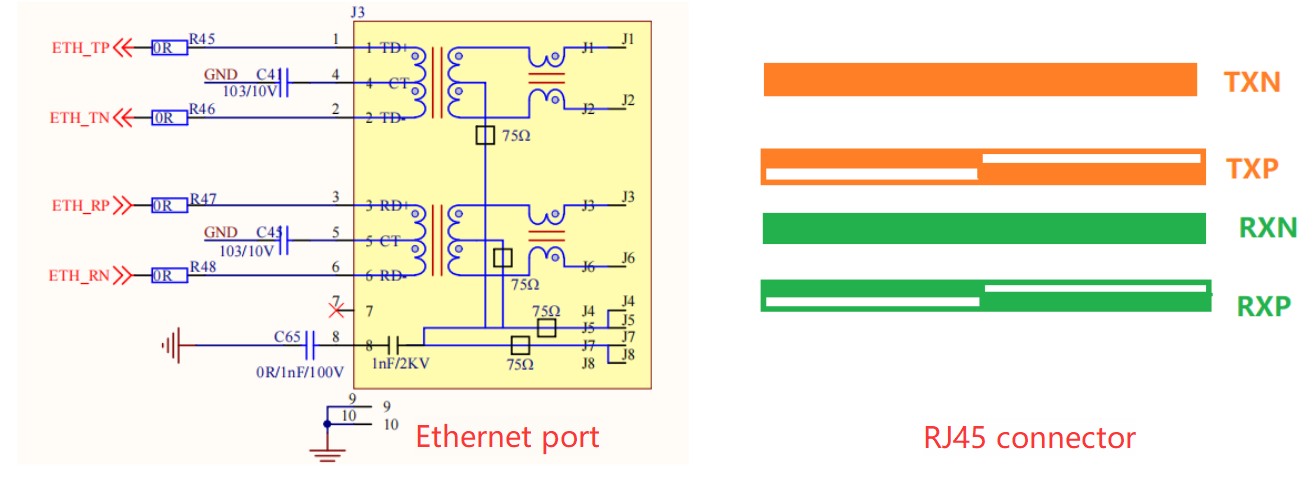

Hello. I have a luckfox pico circuit. now i want to use rj45 port to access via ssh. i used unbutu image and wrote it to sdcard. then I soldered the txp, txn, rxp,rxn pins. I plugged the LAN port into the router and the signal light on the router is on but I checked the IP and it doesn't work. Is there any tutorial that can help me use Lan RJ45 port with this luckfox pico board. Thanks
You need to modify the relevant device tree in the SDK yourself. Additionally, in terms of hardware, our version with an Ethernet port includes a transformer, which you can refer to in the relevant schematic diagrams.

Thank you for guidance. I apologize for not being much of an expert in electronics. Do you have any more specific illustrations?Luckfox Taylor wrote: ↑2024-07-22 10:18 You need to modify the relevant device tree in the SDK yourself. Additionally, in terms of hardware, our version with an Ethernet port includes a transformer, which you can refer to in the relevant schematic diagrams.
