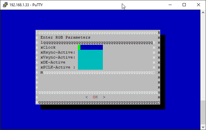

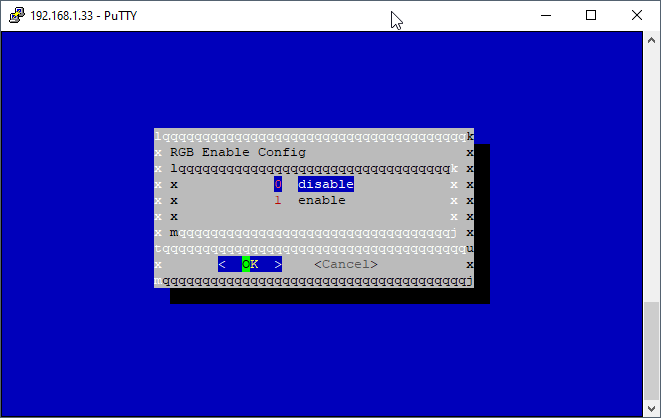

If I run the luckfox-config command and goto RGB section it is disabled by default and if try to enable it, it asks for some parameters which are blank. This step is not mentioned in the Wiki page.

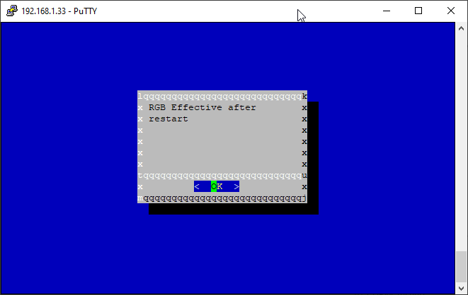

I ran luckfox-config command and then enabled RGB and Touch Peripherals. In RGB peripheral I put panel configuration parameters and timming parameters from the Wiki device tree settings.

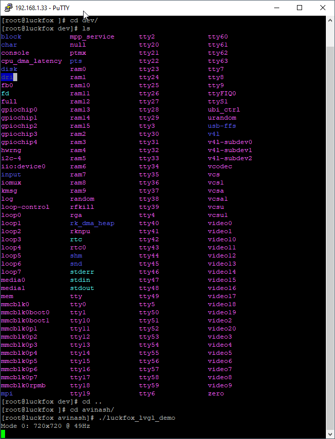

After restarting the board, the entry for DRI was created /dev/dri in rootfs. Then I ran the LVGL demo and woo! It ran successfully.
