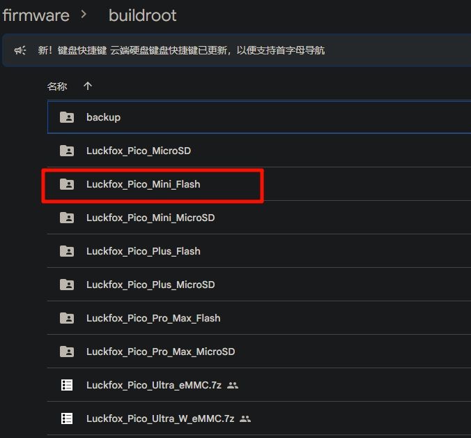

I have a LuckyFox Pico Mini B. I'd like to find the firmware to re-flash it's Flash memory.
It seems like I've gotten it erased, but I cannot seem to get it to either boot off SD card nor re-flash it.
The only firmware I've found seems to be for SD card. I'd like to try to reset it to boot off flash to see if I can get it booting properly that way first.
The Google Drive doesn't seem to have firmware for Flash for this model.

Hello, Google Drive has the SPI NAND (flash) version image for the Luckfox-Pico Mini.
I have gotten that one and was able to finally get it re-installed.

The Luckfox Pico Mini B does not support eMMC (the RV1103 has no eMMC interface). If using SPI NAND, the storage capacity is insufficient to accommodate Ubuntu, so it indeed can only run on an SD card.
