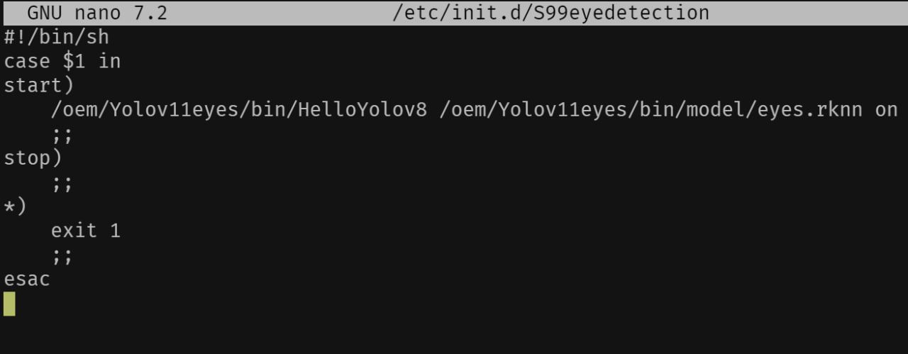

I have a program that firstly, before everything, launches RkLunch-stop.sh, then runs RTSP stream with camera view. I tried to make it automatically run on startup via /etc/init.d/S99eyedetection script, but seems like nothing happens in result. Even RKIPC does not turn off which means the program is not even being executed by the script.
What may be a possible issue?
You can see the script in attachments.
P.S. I tried to run the same command from script in terminal directly, all went well and program was launched successfully.
Project can't run on startup using /etc/init.d
Hello, please add the declaration of environment variables to your script.
Then make sure that your script has been granted executable permissions, so that it can be run directly after modification to determine the running effect.
#! /bin/sh
[ -f /etc/profile.d/RkEnv.sh ] && source /etc/profile.d/RkEnv.sh
# Your Scripts
/etc/init.d/S99eyedetection start
Thank you, that worked well, issue is solved!Crocodile wrote: ↑2025-05-19 8:55 Hello, please add the declaration of environment variables to your script.Then make sure that your script has been granted executable permissions, so that it can be run directly after modification to determine the running effect.Code: Select all
#! /bin/sh [ -f /etc/profile.d/RkEnv.sh ] && source /etc/profile.d/RkEnv.sh # Your Scripts ...Code: Select all
