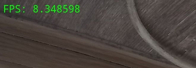

    I get only 8 fps from the opencv-mobile example.
    An example is reading 100 images with a resolution of 2304 x 1296
    and I save only the last one for drawing fps on picture. I do not use any delays!
    This it normal to not expect more?
