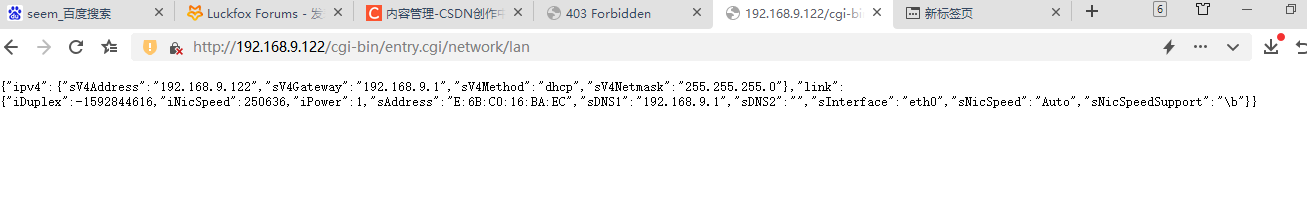

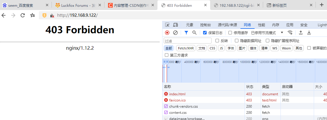

I just star the server and vist the home page index.html, but get a 403 Forbidden page,
But when i vist http://192.168.9.122/cgi-bin/entry.cgi/network/lan
The json seems right
Do you know how to vist index.html?
