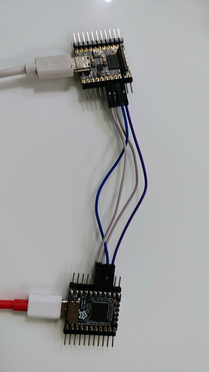

  • As per your recommendations i tried with the loopback test and it is working okay and then tried to establish master and slave communication between two different devices and with partial success i was able to initiate communication but the data is not received properly at slave hereby sharing the output and logs and programs for master and slave

    Hereby sending a photo of the hardware connection for your reference.
    Please suggest a suitable solution to rectify this issue
  • Your connection is still lacking the connection of the GND of the two boards. Refer to the GND of different values may cause abnormal data reception. Please first test it using the example routine from the wiki. Providing testing and debugging for the user's project does not fall within the scope of technical support.
