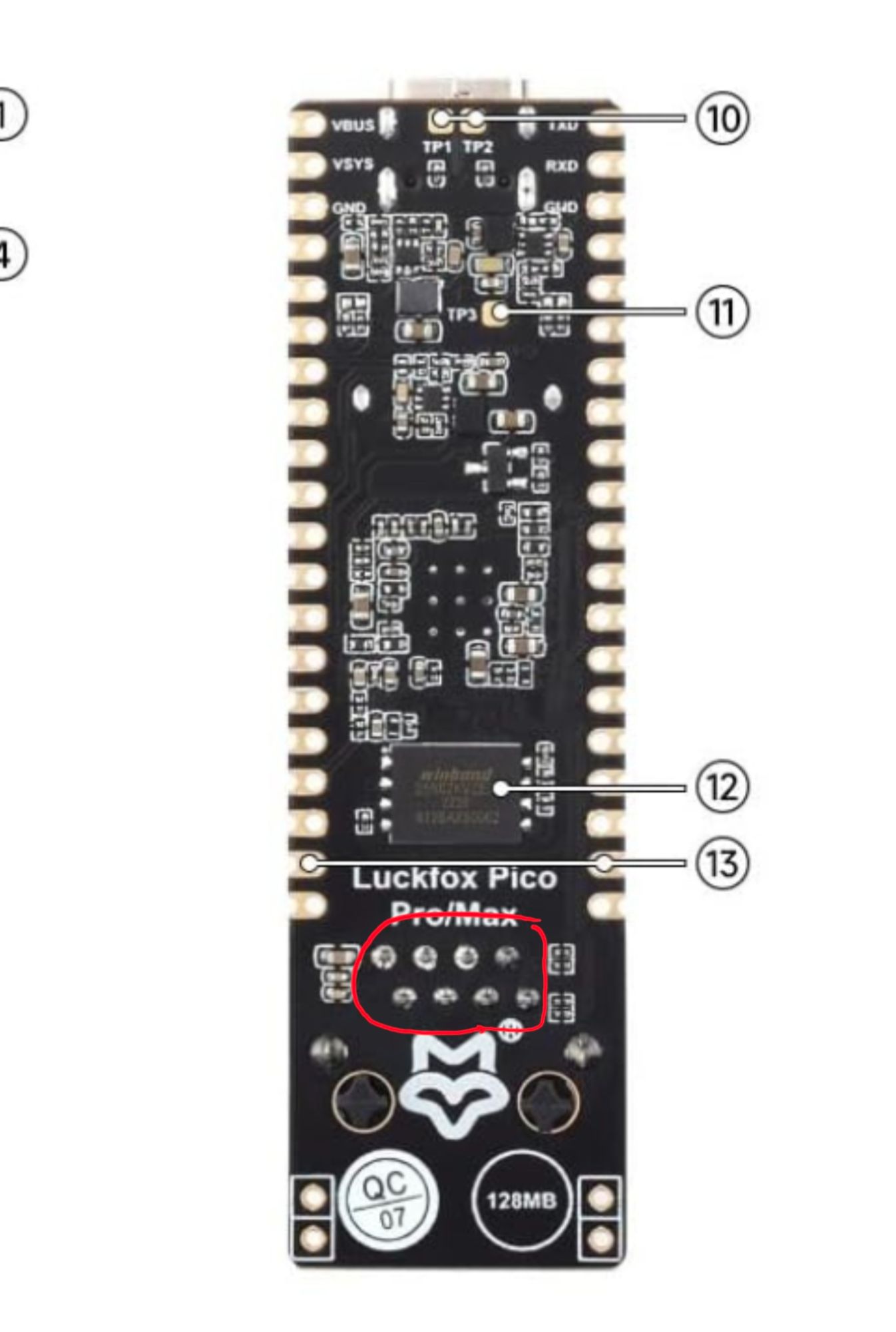

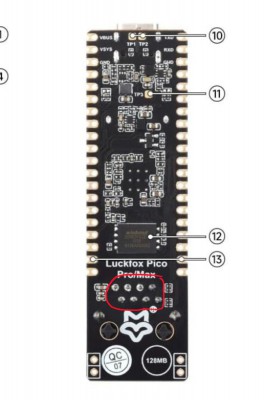

Hello, can someone please tell me the pin out for the rj45 port on the luckfox pico pro. I need to know which is txd plus and minus and rxd plus and minus. Thanks

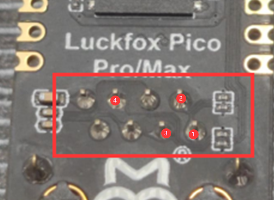

1.TX_P
2.TX_N
3.RX_P
4.RX_N
