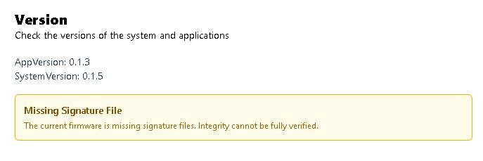

    Just for Information, there seems to be an additional issue with signature files:
  • The signature verification is used in conjunction with OTA updates. The current SD card firmware does not have the OTA update feature enabled. If you directly replace kvm_app from the GitHub repository, it will prompt that the signature is missing. This prompt does not affect normal usage.
