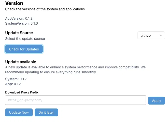

    afterwards the webserver starts and you can perform an OTA Uprade again.
