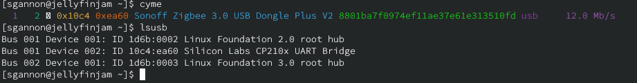

  • PicoKVM determines whether a USB connection is established by checking the UDC (USB Device Controller) status. Changes in the physical signal trigger changes in the UDC state. Therefore, the host being controlled may have already recognized the device, but if the driver fails to load successfully, the PicoKVM information may not appear when running lsusb.
    The host being controlled must at least have a HID (Human Interface Device) driver to function properly. After connecting to the PicoKVM, you can check the system's kernel logs using dmesg to determine whether the issue is caused by a missing driver.
