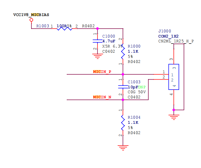

I'm planning to use LuckFox Pico Plus for audio playback and audio recording, so I need to use line-out and line-in ports. As far as I understand, CODEC_LINEOUT output is signle-ended and referenced to ground, so I can connect it directly to headphones/amplifier, is this correct?
For audio recording I will not use microphone, I will use single-ended line-out from another computer, how do I connect it? Is there an example schematic? Also, how can I test the recoring and playback features (what commands? any extra packages required?) Do I ned to explicitly specify that I'm using line-in and not a passive microphone in software?

You can refer to the content in the following manual as well as the MIC reference circuit.
Document download: MIC reference circuit:

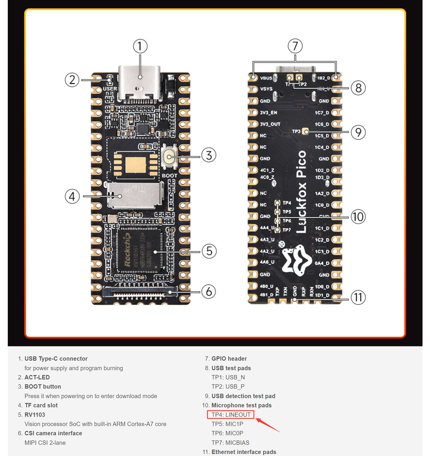

Ok, I managed to play a .wav file using alsaaudio and python. The strange thing is that I get audio output on TP4, but according to schematic for Luckfox pico plus, it's a CODEC_MICBIAS port. Is the schematic on the luckfox website not up-to-date? If so, can you share an updated version.
The TP4 is indeed an audio output interface for LINEOUT.
