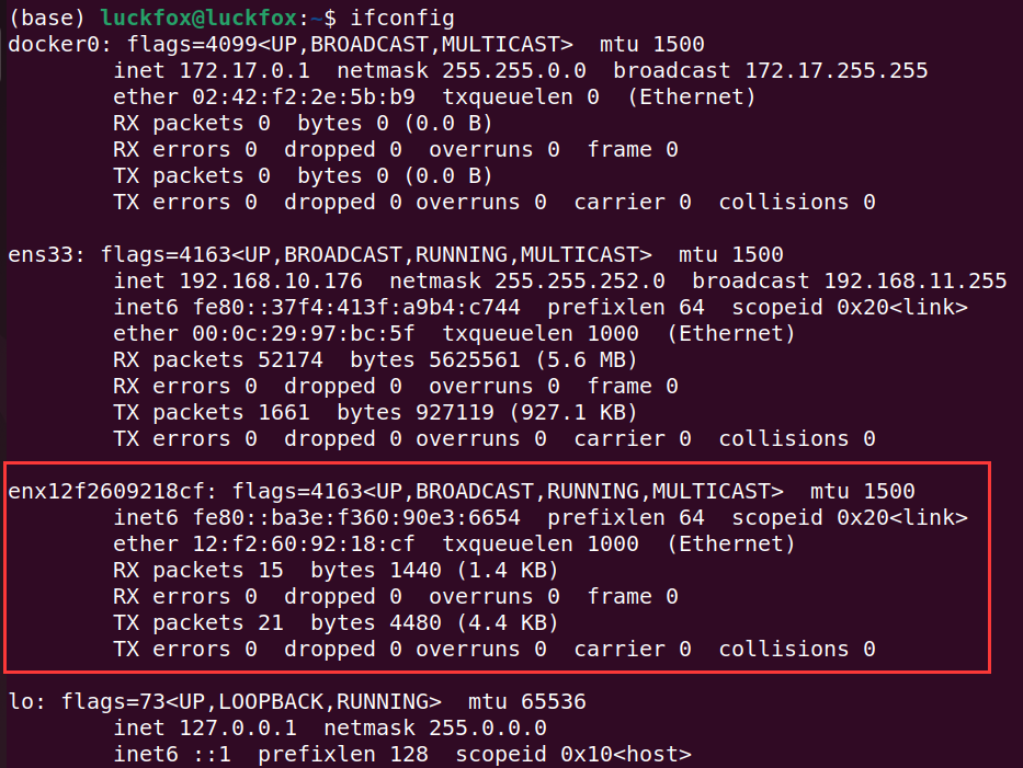

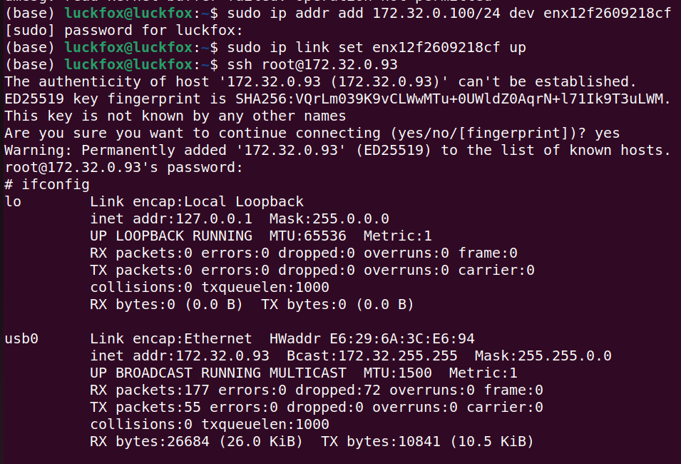

When the development board is connected to a virtual machine or an Ubuntu host, it registers as a virtual network interface. We need to ensure that this virtual network interface and the development board are in the same LAN. As mentioned earlier, being in the same LAN is crucial for successful SSH connection. The current testing is based on Ubuntu 22.04.
sudo ip addr add 172.32.0.100/24 dev enx12f2609218cf
sudo ip link set enx12f2609218cf up
- Posts: 2
- Joined: 2024-05-03 21:55
Thank you very much. This is my first time working with virtual adapters and I confused myself with the addresses.
