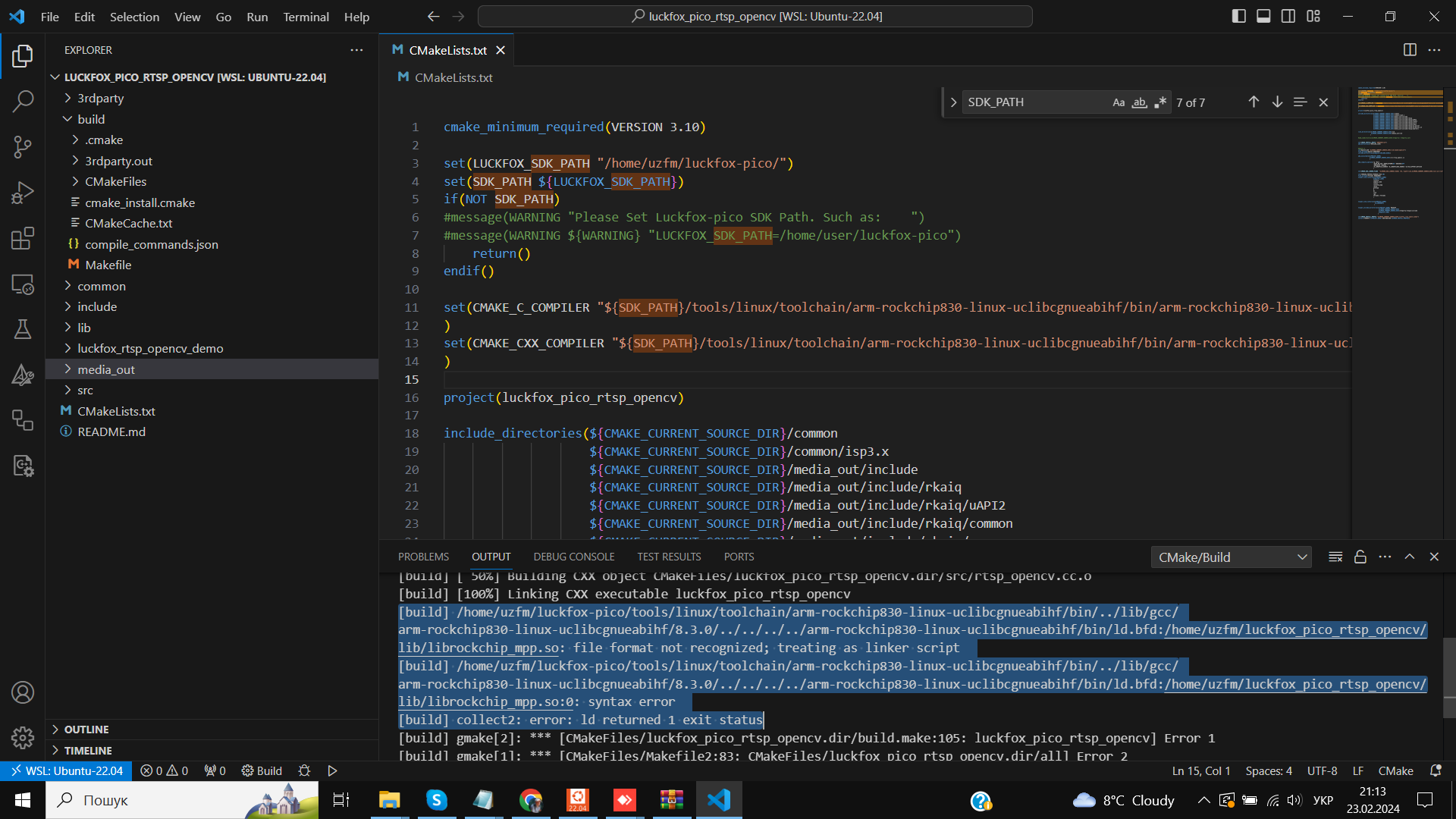

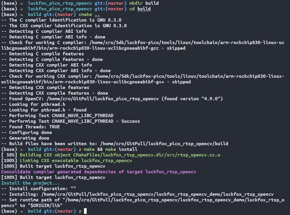

Hello, I conducted tests on WSL1 Ubuntu 22.04 and did not encounter the issue you mentioned. Please note to use git to obtain the source code. Using unzip operations may lead to some links being lost.
git clone https://github.com/luckfox-eng29/luckfox_pico_rtsp_opencv.git
Thank you!

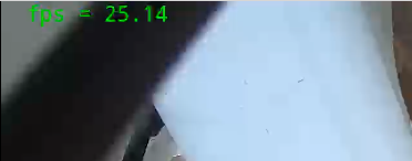

Works great but the quality is very poor.
