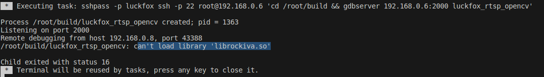

  • When I try to run the program, it ends.
    Can anyone help with this problem?
    There was a problem when debugging the rknn_yolov5_demo program. the program is compiled and works well, but when debugging there is a problem.
    This is from visual code.
    Process /root/RV1106_RV1103/rknn_yolov5_demo/build/rknn_yolov5_demo created; pid = 2794
    Listening on port 2000
    Remote debugging from host 192.168.0.18, port 51596
    /root/RV1106_RV1103/rknn_yolov5_demo/build/rknn_yolov5_demo: can't load library 'librknnmrt.so'
    Debugging information is present.
    command (l ) starts to show information from the end of main.

    opencv-mobile example debugs great!
    The debugging issue arises when using the librknnmrt.so library.
  • Can someone explain what the problem is when debugging?
